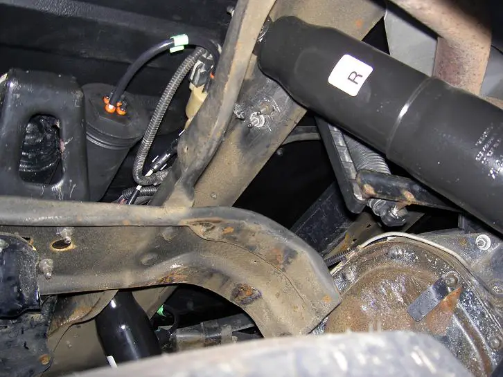

BTW for the ARC system, the air compressor is directly over the spare crossmember. Do not ever hang the rear from the air shocks, that causes most ARC rear shock failures. Only lift the back by the differential, or unbolt the shocks first.
There is a seller in Canada with hundreds of the rear ARC shocks, I bought a spare pair, for $80 total. The air lines are still all available from Ford, buy them if you suspect a leak, they are not expensive, $15-30 each(three pieces).
I added a rear ARC system to my 99 Limited wreck, I know too much about it now. Regards,

The compressor can be replaced, there are a couple of companies that do handle these, and the dryers. Those are reliable parts, usually other issues cause them to be over worked and damaged. Leaks are the main deal, find and fix those.
The ARC compressor is above the spare tire, above the mounting chassis member. It can be removed but be careful removing the air lines from the dryer.
If the compressor runs too often , the high flow of air through the dryer will accumulate too much moisture, ending up with water in the lines and shocks(very bad). The dryer should be able to come apart, and allowing you to "bake" the beads. That is common to do for other Lincolns/Fords, there are how to threads to explain that.
The dryer can also be bought new for about $40. Make sure there are no air leaks, that is always the number one priority.

Inspect all of the parts and decide based on the leaks you find or unusable ARC parts. Usually it's not bad to fix thongs, if that doesn't include all new $160 shocks.
The compressor "hovers" on four rubber insulator mounts, which are surely gone with yours. The car type Ford air systems have different mounting studs/mounts, and I tried to modify my spare Mark VII parts.
I didn't have much luck with that, and found a better and easier answer. I bought a box grommets that were sized just right, that I was able to cut them in half(section) and use the stock mounting studs/bolts/washers.
I suggest first fixing the compressor isolators/mounts, and see how it sounds after that.

Great post CDW. Thanks for the pics.
I'm going to see if I can get the compressor unbolted and out of there to put in new rubber mounts. My truck is amazingly rusted under there, I'll try to take a pic that shows the extent of it. Pretty sure the rear shocks themselves also need replacing.
