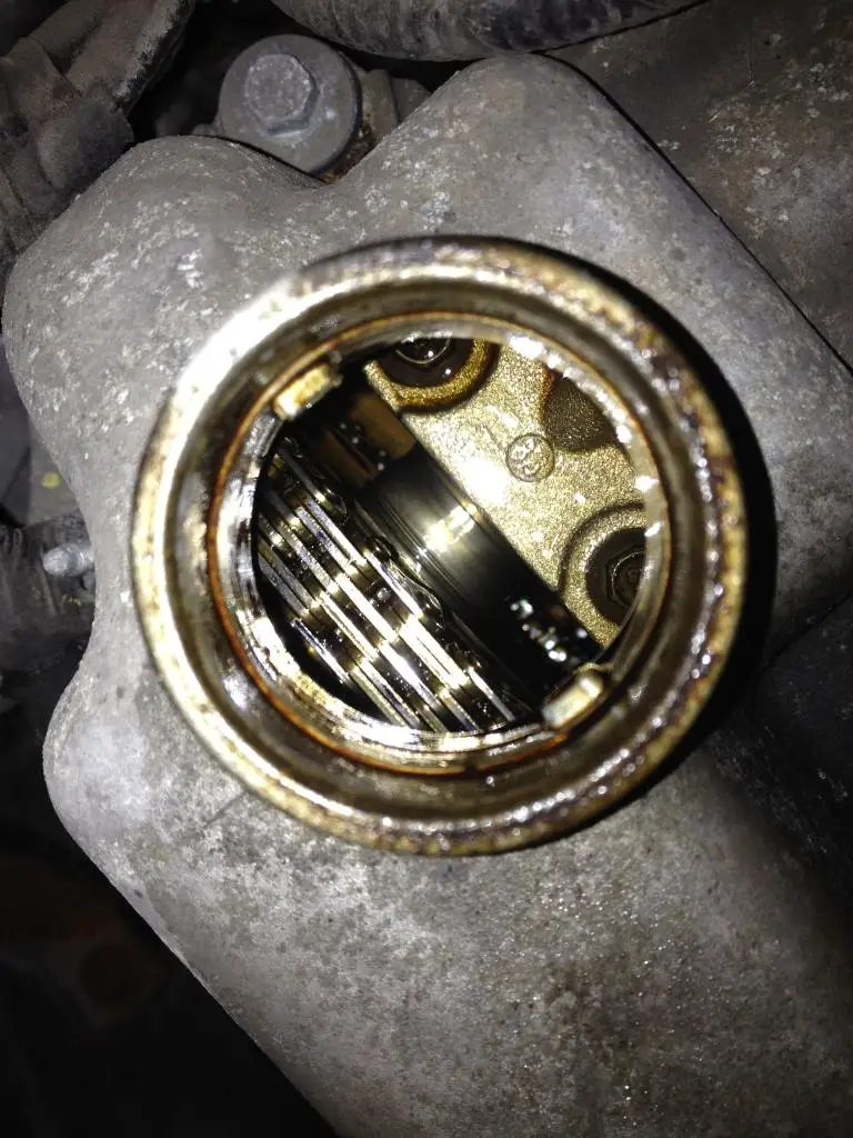

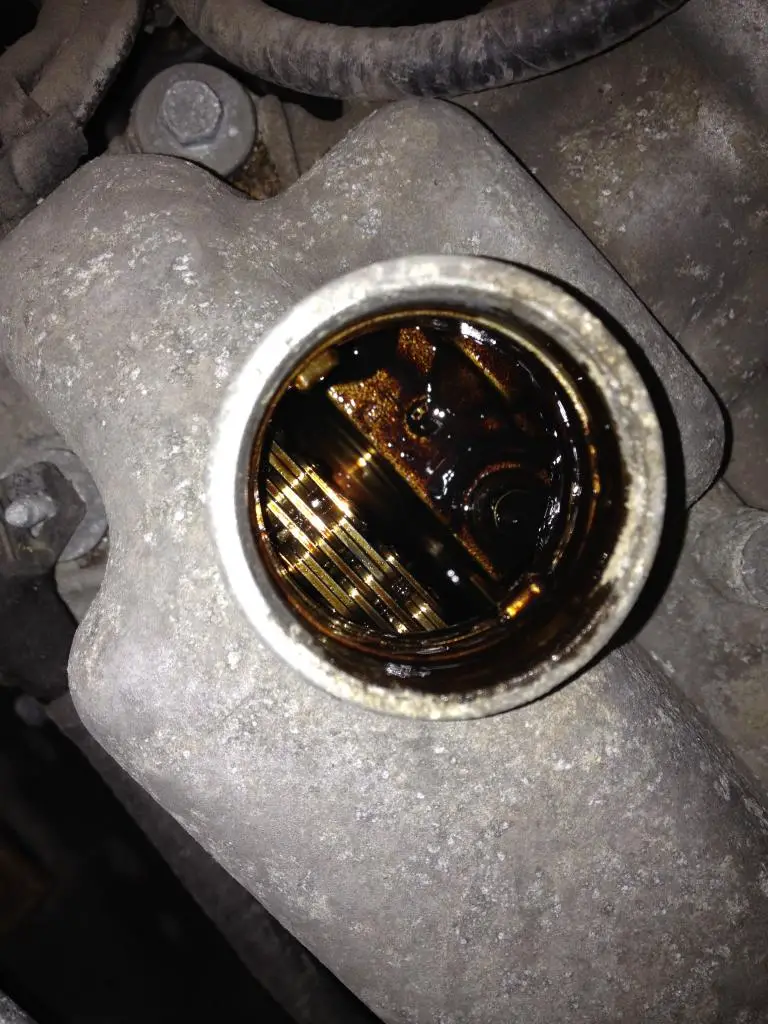

Here is a 2005 Escape V6 with 103,000 miles on it.
Before
After
BTW welcome to the forum.

The photos above were from her running conventional oil ( she changed hers ever 3000 too)
