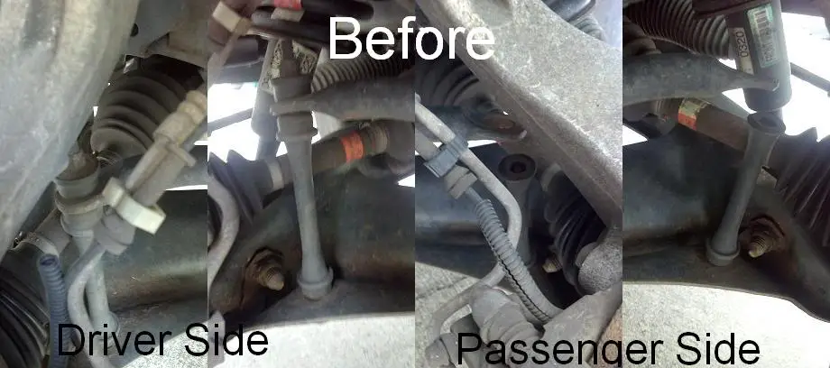

I was driving home from drill this past weekend, and I heard a clank right as I hit a pothole in the highway. I pulled off to investigate, and I find:
I get home and get the parts to work on it, and of course it rains. But finally:
I had noticed that my ride was getting harsher and harsher, and the body roll was becoming unbearable. I attributed it to worn out struts (135K and climbing on OE) and put it aside to be fixed when I got around to it. Glad I heard the clank the other day and investigated. Definitely saved my self some money. Reading around the forum, I discovered that most people here who've had to replace them end up cutting the old ones off. No difference here. I :hammer: on the drivers side for a good while before :sawzall:. The passenger side was so eat up that it just broke off in my hand. Took about 3 and a half hours to get it all done... And it rides a whole hell of a lot better now.
