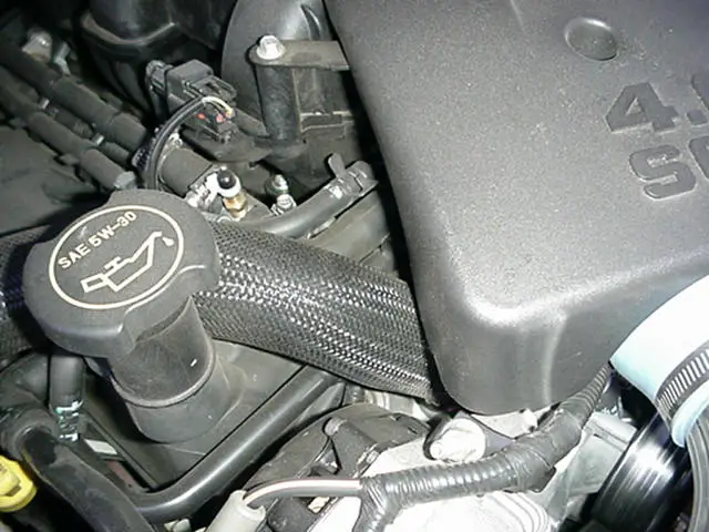

Ck the rubber Elbow ( the large one in the pic)It comes from the PVC valve on the backside of the drivers side valve cover.
They crack on the bottom of the elbow, good luck.
