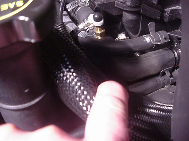

As a compleate longshot ck the following, don't know if your SOHC is the same as the 01/03s, but the PO171 code is common and alot of the time means a vac leak.
One area that is notorious for cracking is the Rubber elbow as it enters the front of the Plenum Pass side (see Pic) the larger of the 3 hoses, hose comes from the PCV valve, back of valve cover drivers side.
It normally cracks on the bottom or inside edge where it is hard to see, remove and inspect it, maybe its worth a try, like I said is a common problem with that code and the newer SOHC V6s
