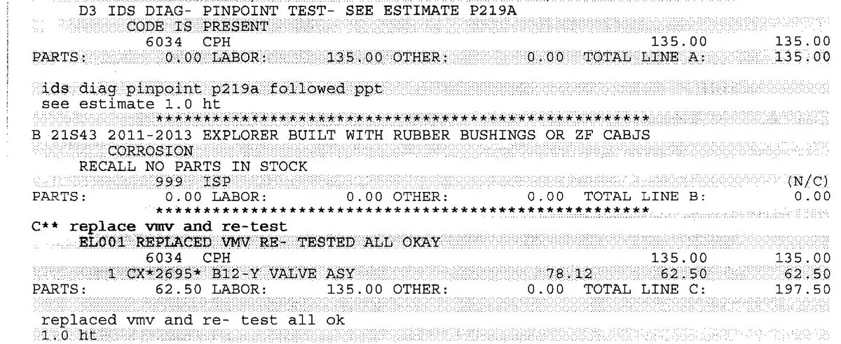

Dropped my Car in 2 days ago to have the VMV (Vapor Management Valve) Installed. The dealership installed the part and Cleared the code, all in all took 15 min for the install and set me back $375. Driving on the Highway this morning the Check engine light is back on. Called the dealership and they say it happens when a VMV is installed and to get it back so they can clear the check engine light.
UPDATE:

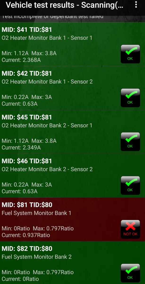

Took my vehicle into the Ford Dealership as the CEL came on with the same code: P219A. After checking the vehicle, the Service advisor told me that the valve they installed was stuck open and mentioned that the VMV is learning and that if I get the CEL again it will go off in a couple of days. The Service Advisor also mentioned that it could be a 02 Sensor that's causing the CEL to come on with code P219A. I am sure they are just going to throw parts at my vehicle until they get to the source of the problem. The CEL came on a few days later and after three days its still on so I think I will take it to a Diagnostic center and have them thoroughly diagnose the issue providing me with documentation so I can get this fixed once and for all without spending a lot on replacing parts that were perfectly fine in the first place. Attached the following screenshots from my OBDII scanner:
