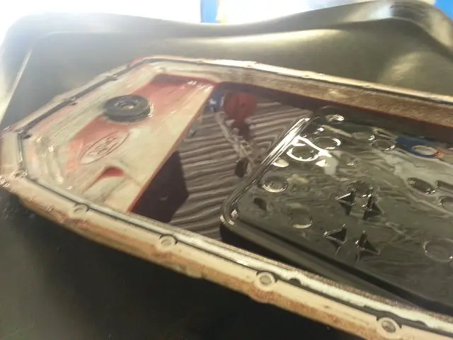

Did a pan drop/filter change today. Saw some bad stuff in there. Also ran a scan tool and found P0735 - Incorrect Fifth Gear Ratio. I erased to code, fingers crossed it stays gone. I called the dealer I bought the ST from and they had records of the previous owner having the trans flushed, but never a filter change. I never liked the idea of flushes without a filter change.
ST has 83K. Mercon SP $7, Ford Filter $15, stupid pump tool $7. Next time I'd buy a long hose and use a funnel.

I searched around youtube and I guess the ATF wasn't as bad as I thought. It was discolored, but not contaminated. I saw some really coffee looking ATF coming out of 6R80 transmissions with the same mileage. The metal on the magnet and pan was just really disappointing to me, but like I said the pan had never been dropped before today.
Good job on the change. I need to find the time to do mine shortly. Did you put the ST on a lift or did you place the car on jack stands? Also, the metal in your one photo looks to be very fine shavings. From what I recall, I dont think that's too alarming. Now if they were larger and more solid, then you'd have issues. BTW, how long did the drop and fluid change take you? Was it pretty messy? I know from experience, ATF fluid smells very strong.
I had access to a lift. I'd hate to do this on jack stands. The shavings were very fine, but more than I was hoping to see. I'd prefer to do a pan drop at 30K to get rid of the "break in" shavings and then every 50K after that, but I bought the thing with 70k so I didn't have that option. It took about 2hrs because I was going super slow to avoid making a mess. The garage I was at doesnt usually let customers do their own pan drops because of messes in the past, but I assured them I would work clean so I took my time. The messiest part was adding the fluid with this cheapo pump I bought. Next time i'm going to use a long hose and funnel and fill it from the top. I didnt think the ATF smelt too strong. Smelt sweet to me actually. But i'm weird like that. I like the smell of diesel fuel too!

Looks fine to me. SP is a little darker red than most also.
Looks fine to me. That magnet isnt bad at all. The fine stuff is nothing to worry about. its when you start seeing pebbles and christmas trees that you have to start pricing out a rebuild.
