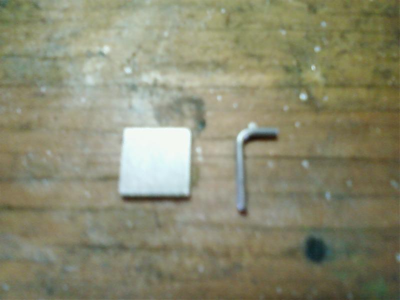

i was cleaning my valvebody in my A4LD and 2 parts fell out and dont know there location its a square plate and a "L" peice , not sure where they go, any help would be appreceiated

The L shaped retainers are most often used mid bore to separate and retain dual use bore contents. The square plus is usually an end plug. The A4ld VB rebuild diary in the stickies section at the top of this forum contains a diagram showing where everything goes.... you will need to systematically ckeck your VB and see what is missing and replace it.
found it thx guys !!
