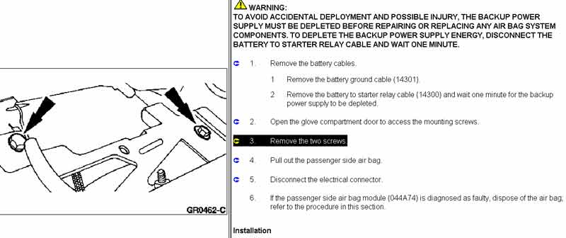

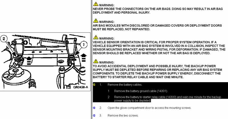

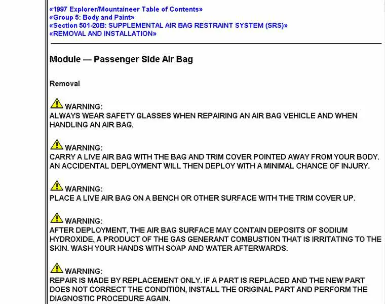

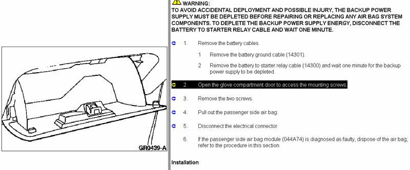

Does anyone know how to remove dashboard airbag panel on the passenger side without damaging it? It has an awful squeek and I think I can fix it if I can remove that panel.

Disconnect battery from truck (both terminals) for 15-30 minutes before working on the truck..
Open the glove box and push the tabs in to lower it all the way.
somewhere there will be two or three 8mm ( It has been some time since I have done bags on an Ex ) You may have to move a duct or something.
Reach around the back, the plug will be attached to a metal bracket.
Feel around you'll find it and get it loose.
Pull the bag toward you and unplug.
Put in a safe place.
