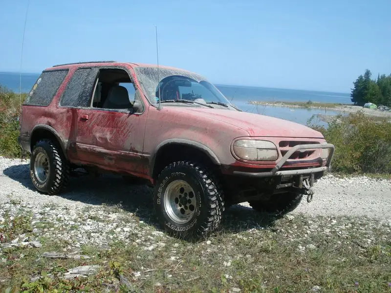

So I do have some damage to the pass door (see pic below), but it was originally damaged last October, and has worked fine ever since.

I got the door panel off. Seems the door damage may have cause a clearance issue between the harness and the glass.
