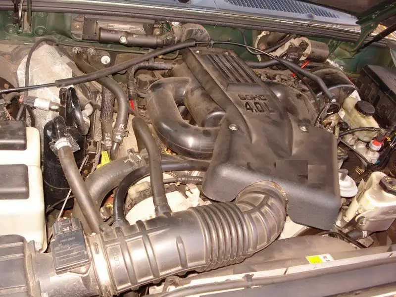

unfortunately i remember to take pictures after i put the engine cover back on so you cant see where the other end of the vaccuum line is.
this is the IAC vaccuum hard plastic tube, it runs up into the intake under the IAV valve. pull this out of the intake tube and insert your funnel
NO your eyes arent playing tricks on you, i had to edit the top of the engine cover because someone drew an inappropriate image in the dust.
