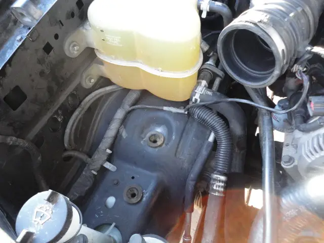

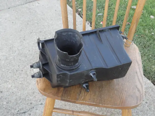

Now to remove the bottom half of the air filter box, you need to spray some lubricant (EX. WD-40) on the (2) inner fender side rubber grommets that stick out of the side of the air box and the (2) that protrude from the bottom of the air box itself. If you look into the bottom of the air box, you will see (2) recessed holes in the bottom of the box. These are the (2) bottom attached, push in plastic prongs that seat into the lower grommets, spray them up the best that you can. Now to remove the air box, pull upwards on the box, while wiggling it side to side as you lift. You have to try to unplug the bottom grommets and the side wall grommets at the same time. It’s a tight fit in there, but it will come out. Use the first photo below, to see what you are working with in the way of those side and bottom grommets.
This next photo below is of the removed air box and what sits underneath it. You can see the 2 bottom grommets that sit in the fender wheel well and there are 2 holes in the inner fender well for those 2 side grommets on the air box. You will also see that a wiring harness runs underneath the air box and what I believe to be, 2 small rubber hoses which carry windshield washer fluid from the reservoir to the nozzles on the hood. If you look towards the lower, center left hand side of the photo, you will see an electrical ground wire attached to the inner fender well. You may need to loosen it (I did) and turn it towards the front of the vehicle, which will give you more room to re-install the air box.

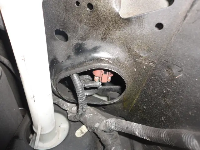

The next photo below shows you what sits behind the air box inlet nozzle where it meets the front support wall right behind the passenger side headlight assembly. You can see that a headlight wiring harness runs thru the opening for the air box nozzle meeting point at the support wall. If you look at the air box nozzle, you will see it has a tapered edge on the bottom side of it to allow room for that headlight wiring harness to fit thru that opening in the wall.
What surprised me when looking at the opening thru the front support wall , was that it was located right behind the headlight assembly, with wiring harnesses running thru there. It made me wonder just how much air flow can really get thru that congested opening and to the engine. Might help explain the poor gas mileage I get.
