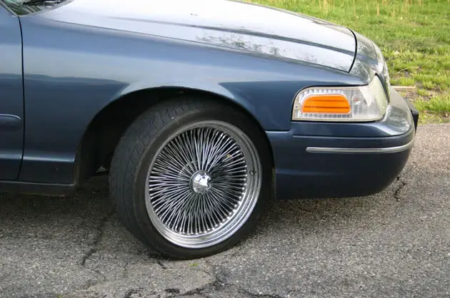

I posted that I will be getting a Explorer from my brother here in a few weeks. Here are the wheels and tires that are going to be going on the truck as soon as the snow stops flying. LET IT BE KNOWN: I am not a big spoke fan however I think that they will due until I get something better. One thing that I am wondering is the fronts are 20's and the rears are 22's. Is that going to jack something up in the AWD? If so I am not going to put them on at all. If not like I said they will be going on as soon as the snow stops...

those are going to be a ***** to clean!!! sorry dont like them!!!:thumbdwn:
Well as mentioned I am not a fan of spokes but because I am part of the 10% elite unemployed in Michigan they are going to have to work until I get money for something else. As for cleaning yea they are a ***** to clean. I helped him once when they were on the vic, and it was no joke. It is not that bad if they are kept up on.
The overall diameter of all four tires need to be same or it can mess up your transfer case.
Well scratch putting them on then I guess! Dang now I have to buy a set.
Dan
You can say bye bye to ur trans and or transfer case if they arent the same size, you can match up tire size but that will look retarded with bigger tires in the front, thats my opinion
or remove the front driveshaft :D
