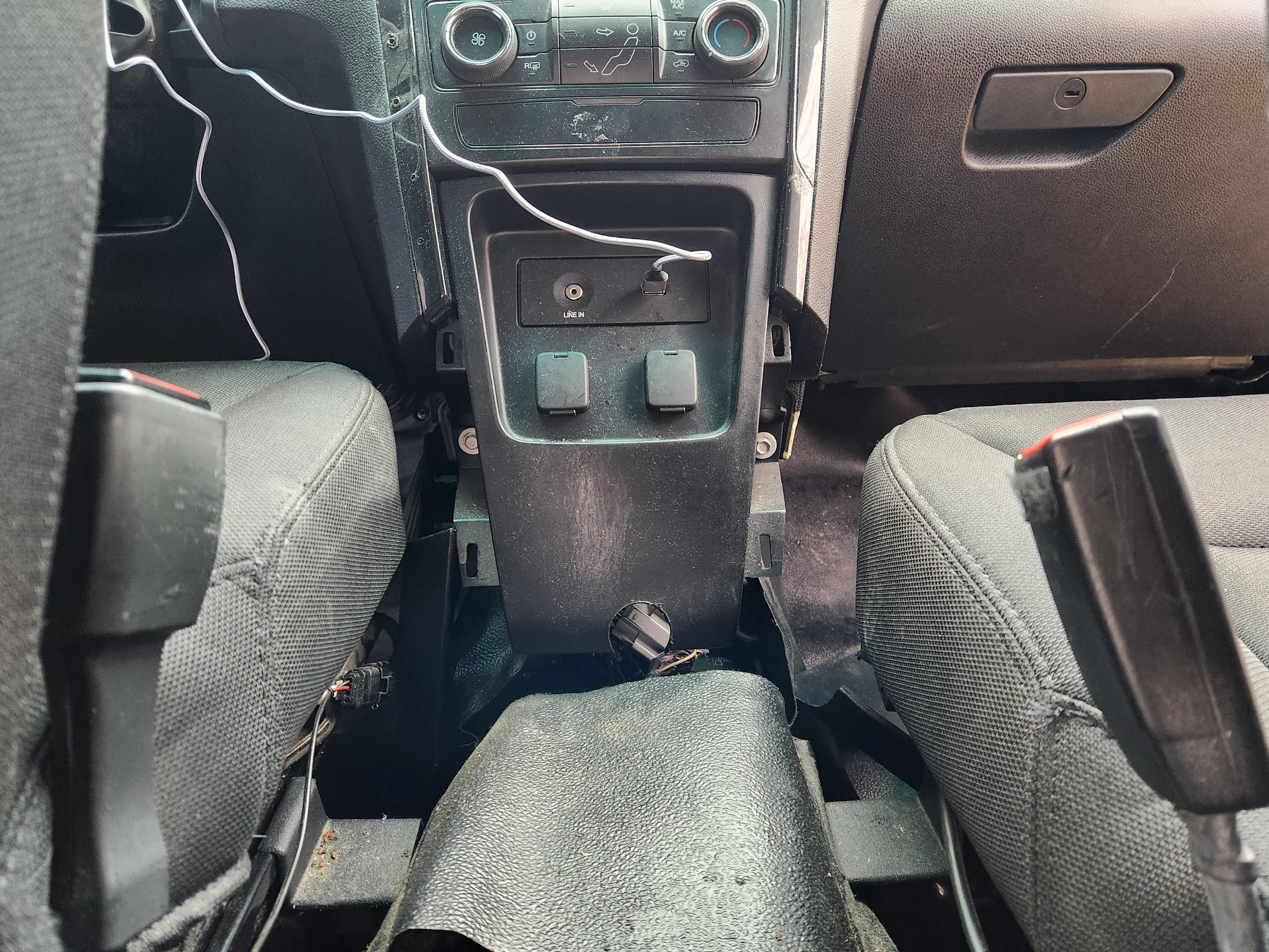

If the vehicle has the USB port and audio input lower in the center stack..is has SYNC. If these aren't present...no SYNC..

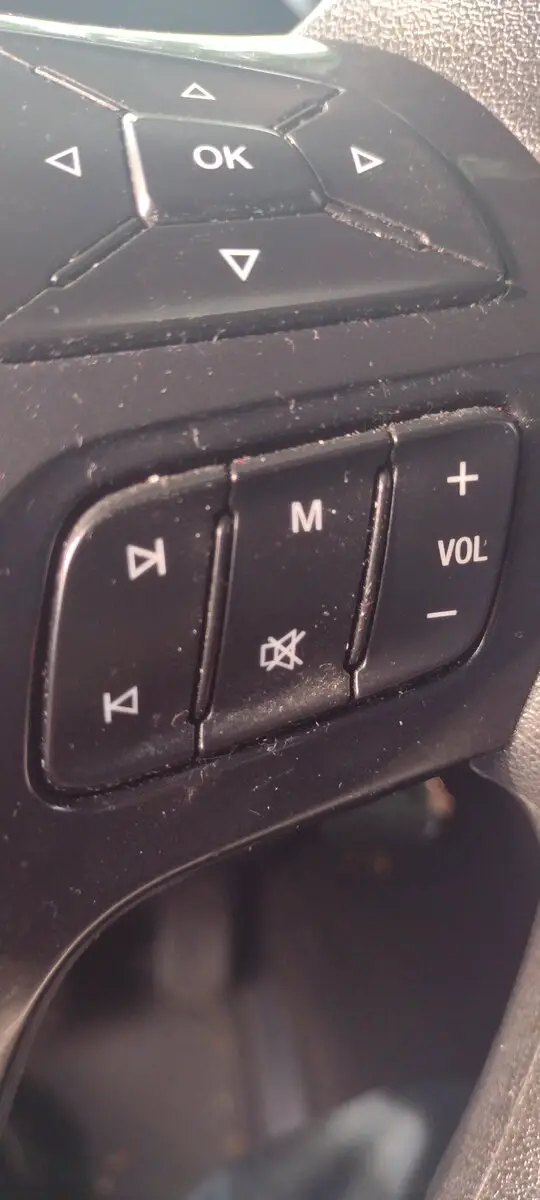

If these are the buttons on the steering wheel, you don't have SYNC.

What is 'audio input lower'?
It's part of what he said. This pic shows "the USB port and audio input lower in the center stack."

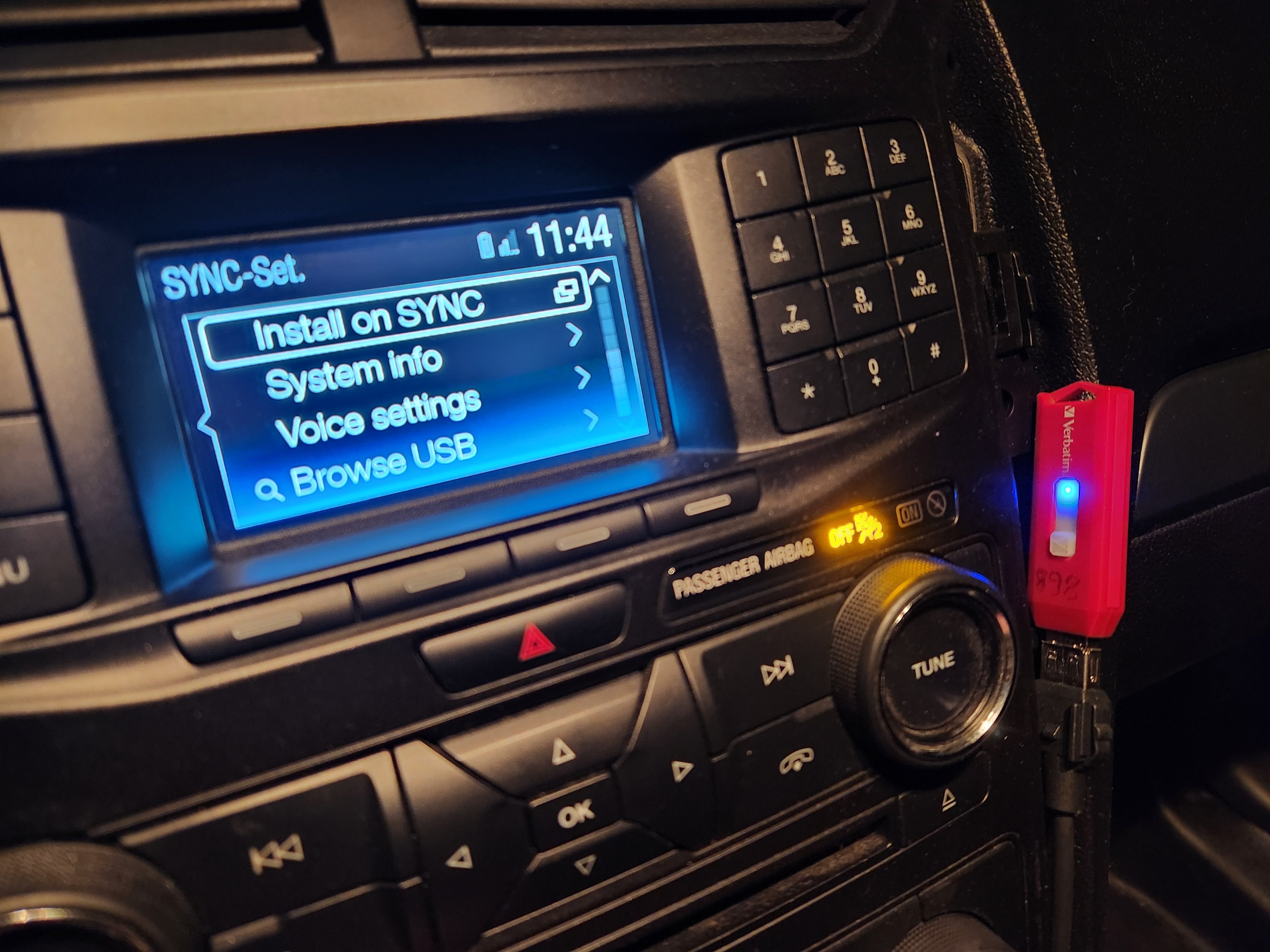

I have a 2015 PIU with the usb, aux, a sync module behind the stereo, and I've seen the window sticker showing SYNC added as an option but I can't get bluetooth or SYNC to work no matter what I try. Any ideas where I'm going wrong? I did the AUX mod and use a separate android auto unit mounted on the dash currently.
...no matter what I try. Any ideas where I'm going wrong?
Not without a detailed list of exactly what you tried. Pics of each step would probably help us help you, too.
One of the first things I did to mine was download the latest software from Ford, and install it. It was NOT a quick or fun process, but it's updated now, and works with my Android phone (but it worked before, too).
