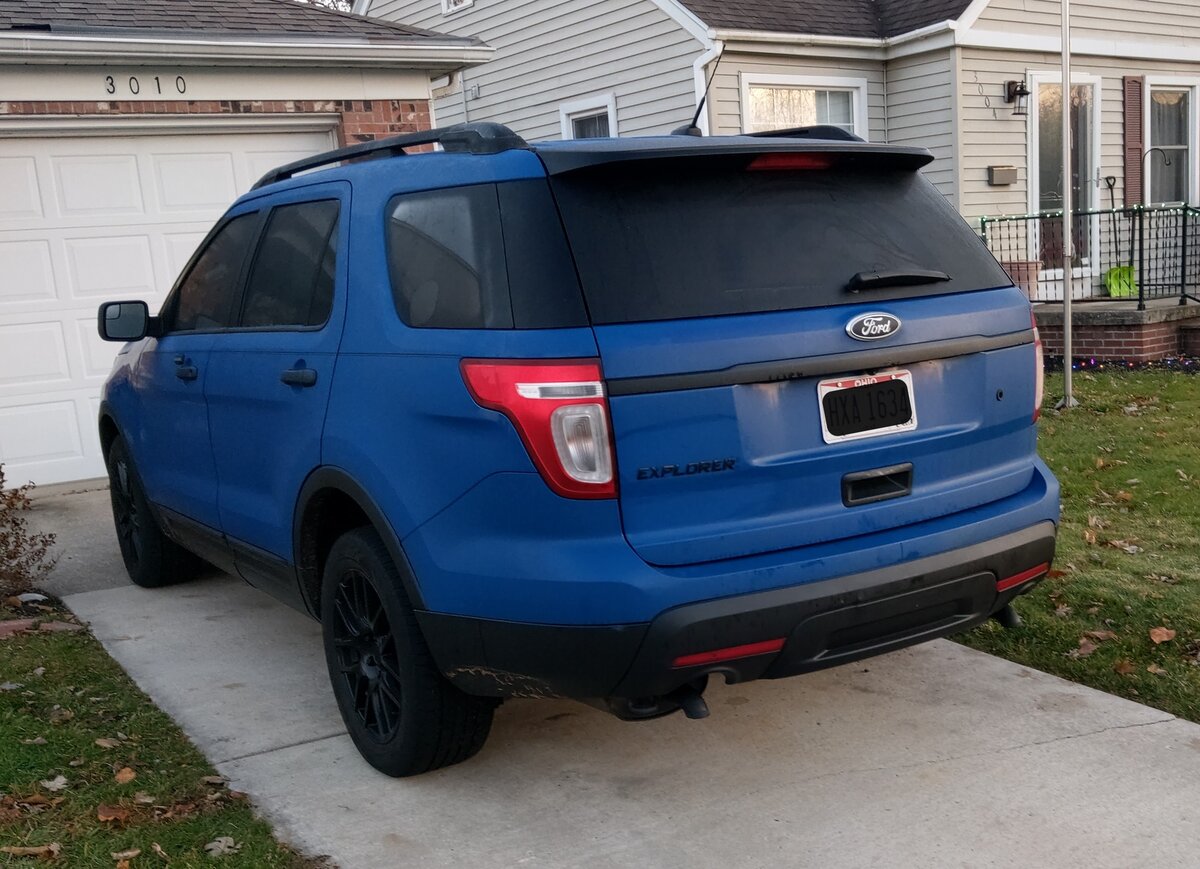

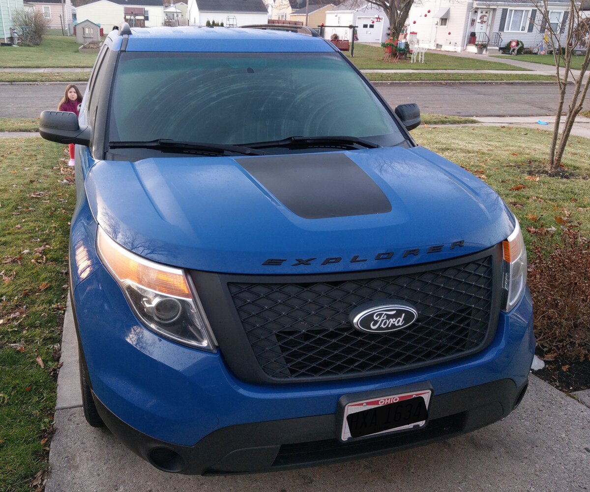

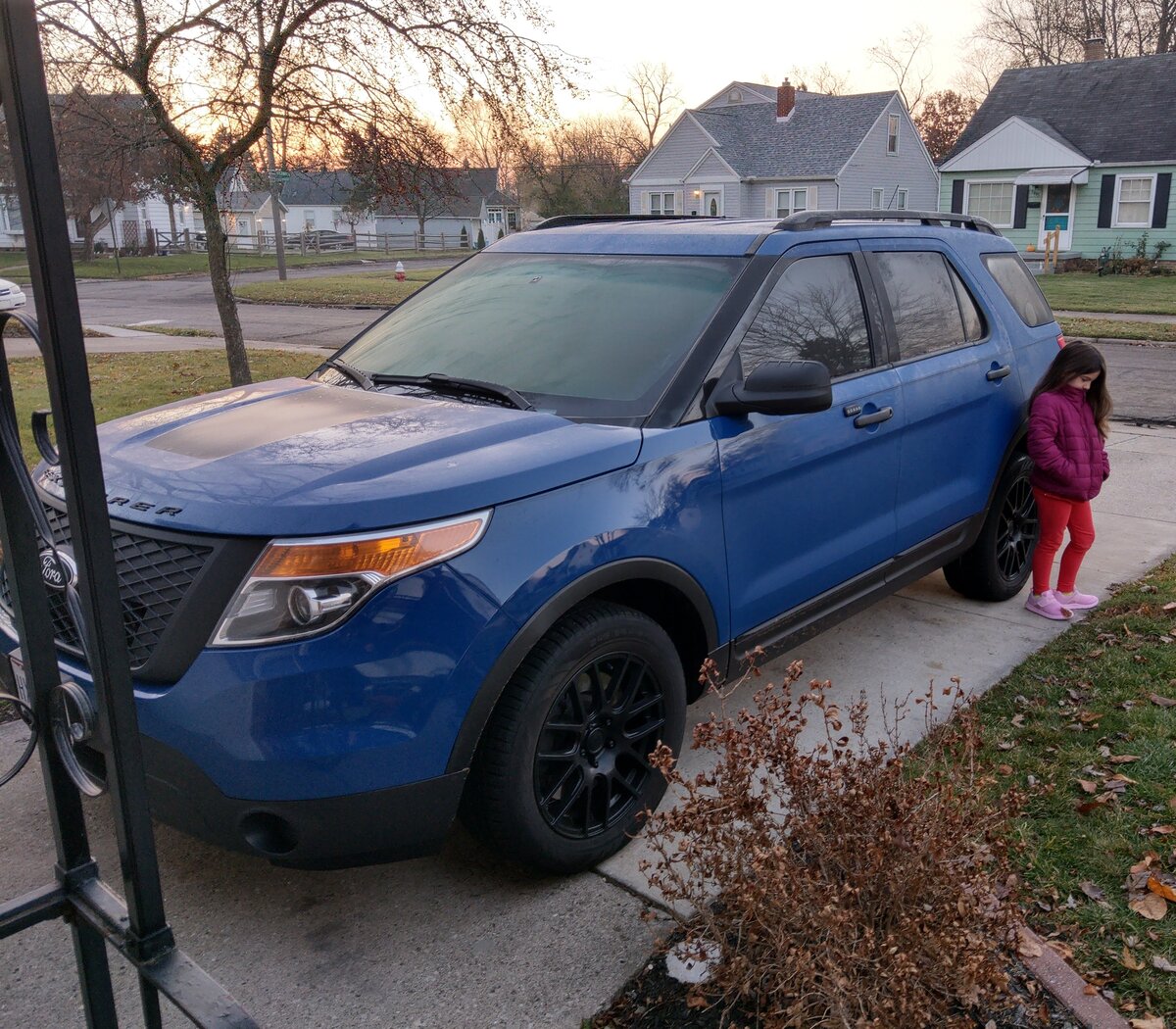

UPDATE: Here is the wrap job! Done entirely by myself, the wrap itself took just a touch under 2 weeks. Roof rack is en route, measurements are set I just need to fab a square pipe bender, and fix my welder..
Looks fantastic! Great job! Was it hard? Did you have trouble with curves or the bumpers? Did you remove headlights, taillights, etc? I am thinking about doing a wrap myself.

Alright! Here's my writeup on the wrap.
Cost, I ended up spending 880$. That's 55' of Avery Satin Dark Basalt, 10' Avery Satin Black, 10' Avery Gloss Black for an overall 75' material. I have probably 6' left of the Dark Basalt, and lots of scrap pieces. Compared to all my other options, this was by far the cheapest. I'd do it again over painting.
I had to re-do the drivers side rear door because it started raining right as I was finishing it up the top of the door panel, and I had to re-do the rear quarter panel on the gas tank side twice, once because my knifeless tape job I did was not good enough for me, and twice because my sister dinged the panel with her door and tore the vinyl. Luckily that panel was small and easy. Everything else was done in one go. I haven't wrapped the inside of the doors, yet. I tried to remove plastic trim as much as possible, the lower door trims, the trim around the wheel wells, the weather strip on the bottom of the windows, I removed the door handles so I could properly trim it and use a heat gun to lay into the pocket behind the door handles. Be careful, you can pop the latch assembly out of place, and it requires you to remove the interior door trim and pull it out from the inside of the door to reassemble it.. huge PITA and I did it twice.
Hardest parts... the bumpers, they required about 8' each and I had to order more to make it. The hatch and the roof were also a challenge.
-The front bumper, I removed the grill and headlights and then mounted the bumper back on, but left out the two screws that connect the bumper to the front quarter panels so I could pop the panel out slightly to tuck the ends. Not having the grill in the way made folding down the vinyl into the recessed portion of the bumper easier.
-The rear bumper was very similar, I took out the screws that held it to the wheel well out, so I could tuck it easier on the ends. I did not remove the taillights, instead I cut with excess and tucked it using a credit card. Nerve-wracking.
-The rear hatch, seemed very straightforward at first but had alot of sharp angles that turned into stress points, causing wrinkles everywhere. I removed all the badges and the plastic trim that holds the license plate lights. I started at the center of the license plate area and worked out dividing the speace in quadrants.
-The roof.. I spent most of the day prepping the surface and the rest putting it down, working it out in quadrants like I did the hatch. Super stressful as I only had one shot at it. I removed the antenna by dropping the headliner a bit, disconnecting the two plugs that feed to the antenna, and unscrewing the 10mm bolt that held it clamped. You can also get to it by popping out the rear ceiling LED, but you need to drop the headliner to disconnect anyway. I used the heat gun alot to be able to tuck it along the raised parts of the roof. I tucked into the top of the windshield using two credit cards. One to spread the weather seal slightly and the other beside it to tuck, working from the center out.
-Something I didn't need to do that would without a doubt be difficult for you. Because of the way was the car was previously painted, you can see I divided the space between the rear quarter panels and the upper parts of the sides of the roof. If you look at my previous pictures of the car you can see where I used knifeless tape to trace the edge of where the motor pool painted the quarter panels blue. I had to do it twice, once for the first line, and again when I went to lay down the satin black. If you end up doing this yourself and you want it to be one color, you will need to do the rear quarter panels and the satin black parts of the roof in one long piece per side, or divide the space with a seam that wouldnt look too good if it's all one color. You'll likely end up with a good amount of extra, unusable material that is just a bit too small for the other panels.
Prepping, other than those pieces that car was pretty straightforward to wrap. I spent more time prepping the surface than actually laying down the vinyl.
-I cleaned the surface and the surrounding surfaces with dish soap and then a damp rag, blew it off with a compressor to make absolutely sure all water was gone from any crevices, let it dry for a bit just to be sure. Any moisture on the panel or more importantly in the cracks where you will be tucking will result in it peeling back and not sticking. You'll have to re-do the panel.
-Wiped with 70% Isopropyl and a microfiber, usually I did it several times ending with a wipe using cheap paper towels to make sure no strands from the towel were left behind.
-Spray with RapidTac, wipe with paper towel. This solution added adhesion, honestly I'm not sure if it was necessary but it sure didn't hurt to use it.
Quotes. When I started shopping around trying to figure out if I should paint/wrap I got several quotes from people in my area.
-Painting the car, I got quoted 4800 from a professional shop, and 3000 from some guy who has his own "paint booth" (garage). That includes stripping the paint, covering any dents, paint and clear coat. I also got a quote from line-x for 3200 to cover the car in bed liner :crazy:
-I got quoted 3500 from several places to have the car wrapped by a professional. This did not include wrapping the inside of the doors, painted interior panels, or the roof.
I did this in my driveway and it took me probably 11 12ish hour days to complete the car. Even though I was super careful and went slowly, there's still some errors, but you'll never get it entirely perfect. Some ridges on the roof are starting to bubble up after a couple weeks, likely I can heat those up with a heat gun and poke them with a pin to settle them. The inside corners of the recessed part of the rear bumper are bubbling too, this happens when you try to pull over a corner instead of using your squeegee to push over the corner, without tension. Others are areas where I trimmed too close to the panel and you can barely see the blue when you look into the crack. On several panels there is one spot where a tiny piece of dirt got under the vinyl, and you can see it if your standing next to the car. That's what I get for not doing it in an enclosed space. Seriously the people who do this professionally must be doing this in a paint booth because I was so meticulous. Still, I'm satisfied with it and any random person would not notice these things unless I pointed them out.
Once my car is back from getting the recalls taken care of this morning I might try to take some closer pictures of the wrap if you all want some. They've given me a 2020 Explorer courtesy vehicle for the day, and it kinda sucks to be honest :shifty: like c'mon why make the shifter a dial.
