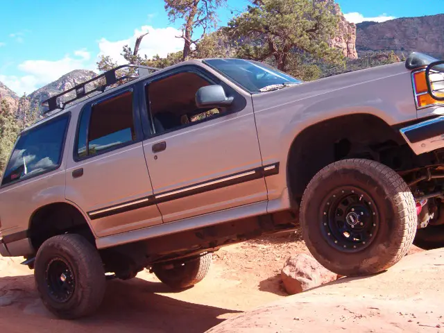

I thought 33s looked small with the 4" lift so that's why I eventually went with 35s. This was also my daily driver for 3 years.
Here is the 4" w/33s and no rubbing issues.
well i had 33x12.5's and they rubbed maybe 33x10.5's wouldnt rub i think they all look small but i dont like hearing tires rub

For a while I had a 3" BL and the 4" RC lift and only 31/10.5/15 tires. It looked kinda silly but I could pretty much max out the suspension and not get any rubbing. After like a year I saved up enough and bought 35"s.
Here is a pic of the 31"s...
