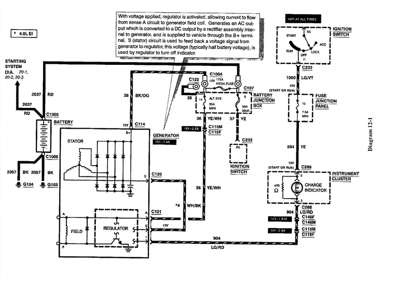

Welcome to this forum! Your vehicle uses high current fuses unlike the older vehicles with fusible links. Take a look at a schematic of the charging system, and trace the wiring. Always start with checking all of the fuses.
charging unit
Do you know of a site where i can get a schematic of the charging unit?
If you search this site, you should be able to find one.
i dont understand though
where is the alternator in this diagram? i showed my cousin and he doesnt understand, sorry for the newbie question
Look in the lower left quadrant of the diagram...
It is called a generator there...But one area to look as well in the mega-fuse being blown...If you do not have +12 volts at the stud on the back of the alternator the mega fuse or the positive lead is defective/damaged and needs to be repaired or replaced...
