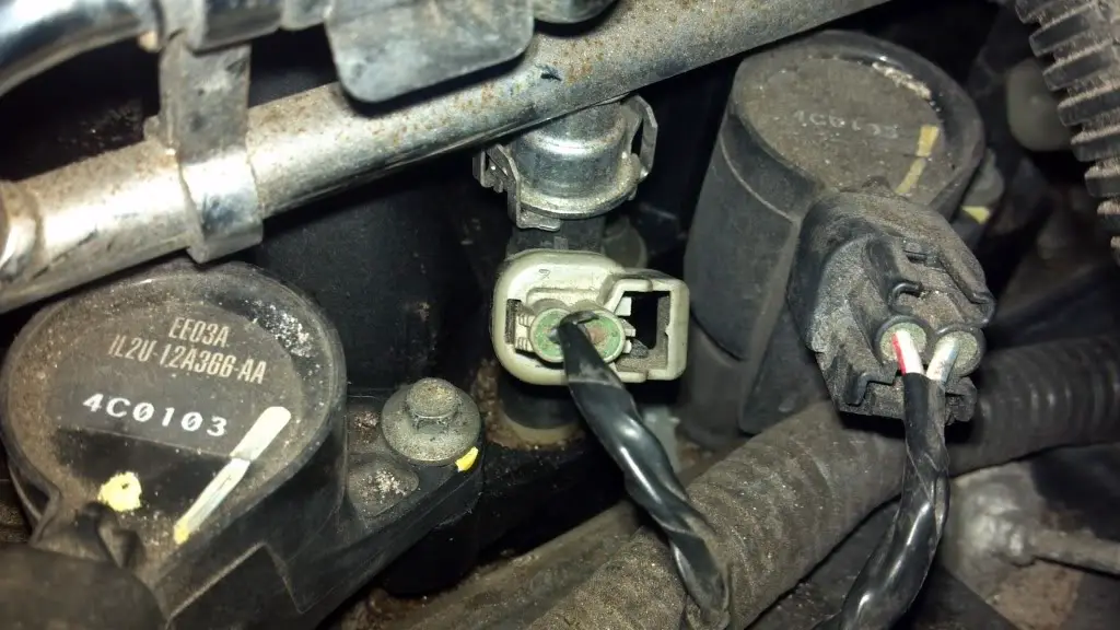

could someone please tell me what this greyish greenish connector is between the two coils, the lock thingy broke off when i put it back on...uhh...do i need to replace if so, what is it and where do i get it. thanks
those are fuel injector connectors, they're brittle and easily gets broken. You could buy a new one and splice it or just zip tie it.
they're in rockauto.com for $23, look for "Fuel Injector Connector"
correct, they are the fuel injector connectors. I used to own a shop and they broke all the time, we just zip tied them on and never had an issue with them after that. IF the connector came off you would know it as the engine would have a 'miss' because there there would be no fuel to that cylinder.
Its amazing how you can go there and link it like that so fast and i spent 45 mins and came up dry. thanks alot. i love this site!!!
