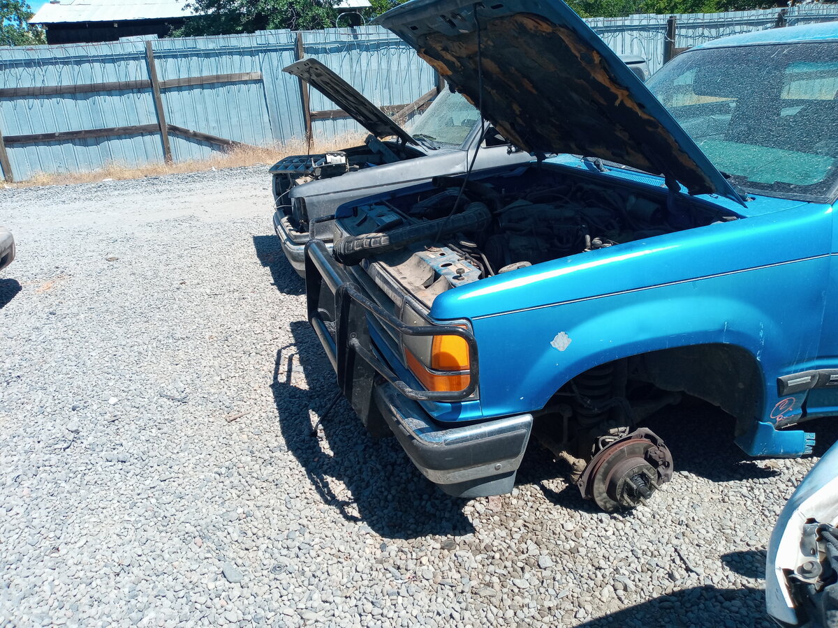

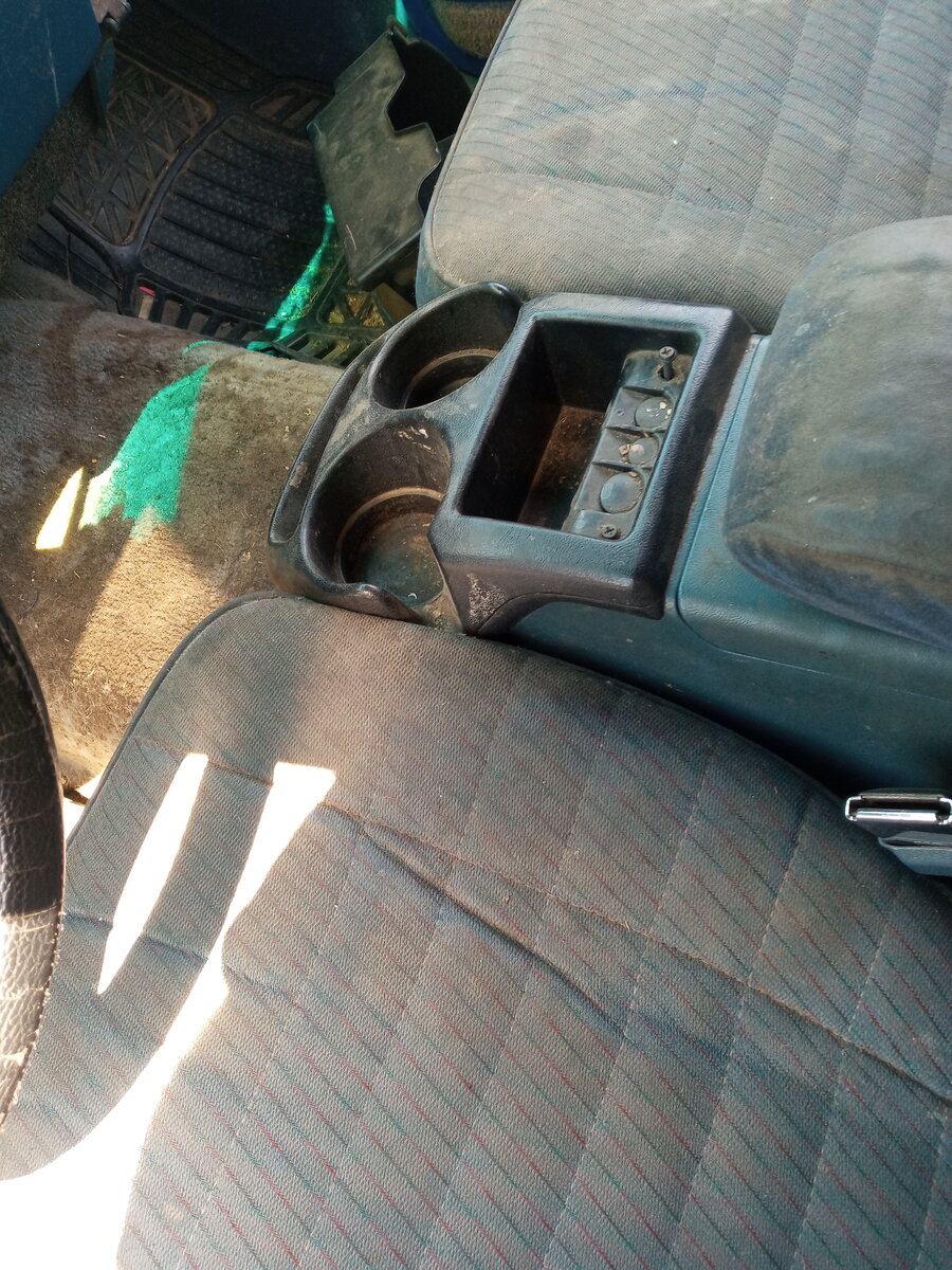

My plan of approach is to find a Rabs valve body probably from my local junk yard and replace it. I will probably try checking there maybe before I get a new valve to confirm that fluid is going in and not out the valve. Heres a pic of a parts vehichle at the junkyard. I got the rear glass gas springs and a double cup holder. Dont really know if the cup holder will work out to good. I might trim the center console a bit. The top two holes line up.
I'd grab that brash guard, those are pretty rare these days. Man it's sad to these in the junkyard. But some must die so others may live..
The cupholders will interchange. The console plastics are the same up the the end of Ranger production in 2012 or so? Newer rangers reused a lot of first gen interior parts.
