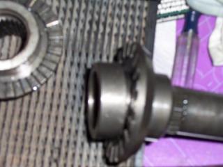

Hey hey, forgot to post back in here. John and I ended up working out a deal and I got the locker. Installed and tested it at Gilmer recently. The only issue I had with the locker was during the install. The c-clip for the axle shaft in the TTB actually clips on and doesn't fall off with a release of pressure on it (like the 8.8 does). I decided to clip the axle in place before putting that side of the locker in place completely for the ease of clipping it in. Also, the clip stuck out just barely too much and kept the spacer for the locker from going in right (pic attached). Other d35s may or may not have this issue. You can see that the spacer is not sitting right in that pic. I decided to grind down the edges of the clip to allow the spacer to fit. Be careful if you're doing this. If you grind too much, the clip could crack or break. I only took the minor offending sections off and left plenty of structure there. You may be able to install the locker easier with knowing the clip issue I had. It worked just fine at the Gilmer trip and I expect it to continue :) Thanks John!
