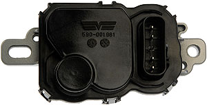

The PCM uses the output of the fuel pressure sensor to vary the speed of the fuel pump (to maintain the desired fuel pressure at the rail) via the fuel pump driver module (pulse width modulator).
