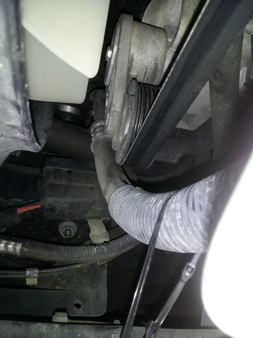

1. The rub noise might be the Serp. Belt rubbing on the A/C hose, ziptie the hose back away from the belt, the shop probably didn't know about this and didn't check.

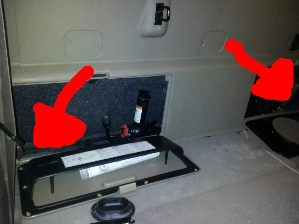

3. They might have dropped a socket into the rear cab cavity behind the seat, I did this when I did my body lift (I got it out with a telescopic magnet).
I'd almost bet they didn't take care of that. Don't start the truck again without getting that done!
Agree. Did it myself because the socket was a little loose on the extension. Pulled it out with a telescopic magnet as well.

Is this the hose and areas you guys were talking about? I told the fella prior to him getting started about that issue, he said he checked it out, and it appeared OK.
I threw on a few zip-ties for reassurance.. hope this is the place all the fuss is about (the hose did seem to clear it decently prior to the zip-ties):

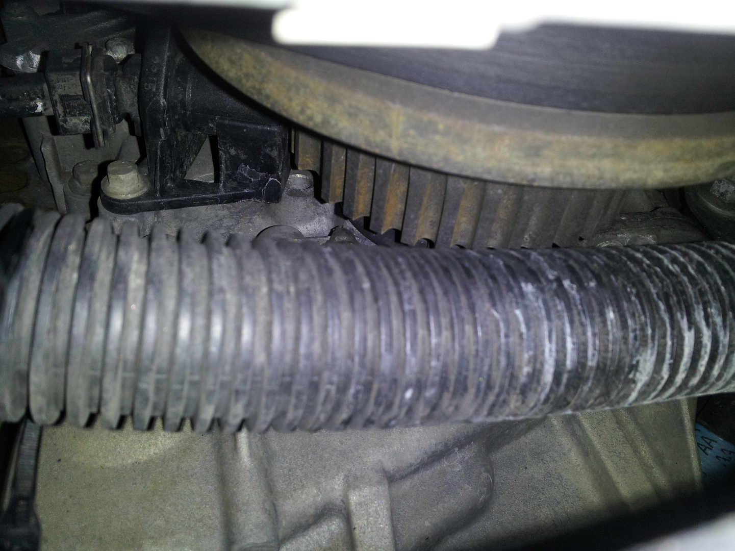

And I read in another thread someone else had it rub against another pulley, which I put another zip-tie to prevent ( I can already see a little rub on the hose from that pulley):
Also, where you guys were talking about losing the socket- are you talking about these areas? I dug around in there with my telescopic magnet, but didn't get any 'bites' :/ I also tried to recreate the issue, but couldn't at the time (maybe it fell into it's final resting place):
Yep, that's the hose, good you pulled it away from the pulley and belt. Those are the body bolt pockets where I had a socket fall into a couple time until I finally through some electrical tape on extension and socket to keep it on. There's a big cavity under there, it probably moved somewhere you can't get the magnet to or they used a crap socket that's not magnetic.

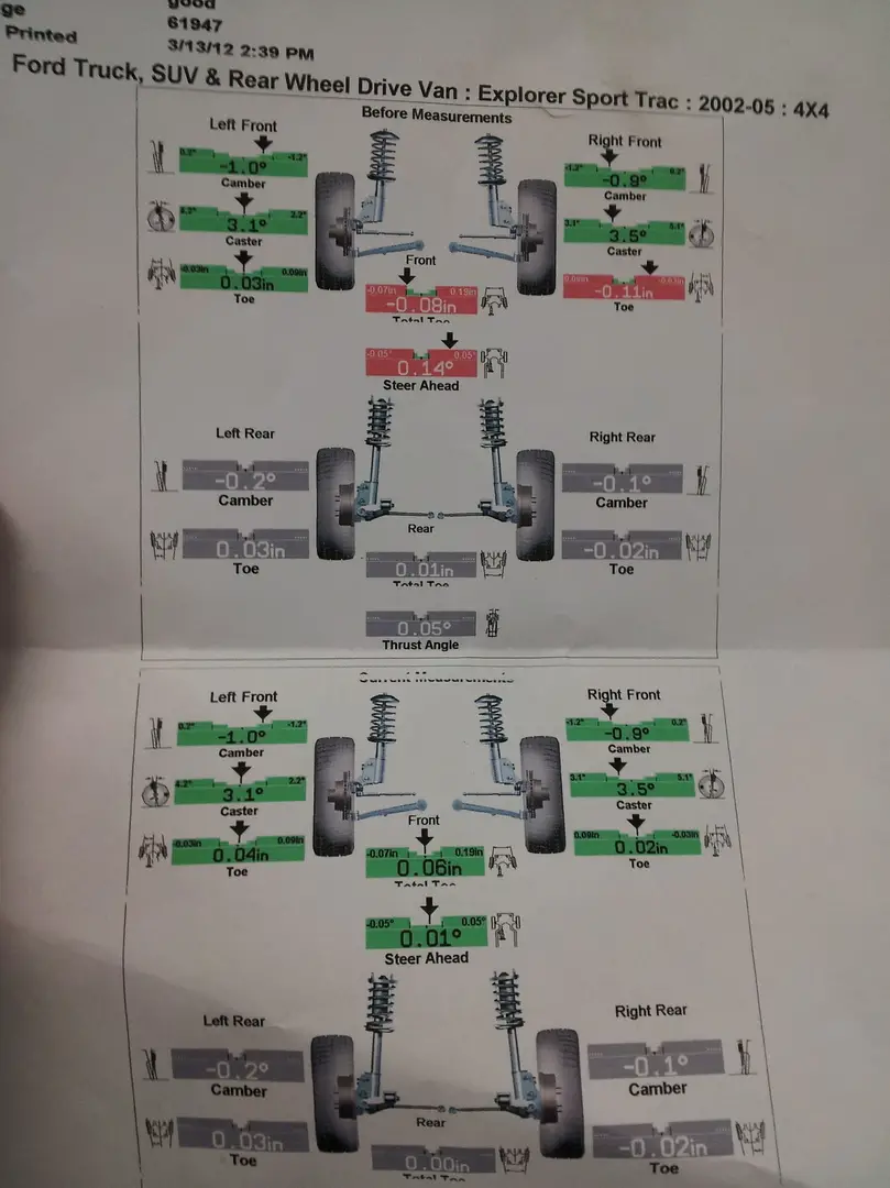

Ended up taking the truck to a Sears Auto, where the techs stated I wouldn't need that kit.
From what I understand, doesn't the truck go out of alignment pretty easy if I don't have that kit? Or does it vary from truck to truck.
Here's the results they gave me - It's a 6 month warranty on the alignment, so worst case scenario, bring it back in and if it tests terrible on alignment, I'll have them put the kit in for a charge, but align for free.
Looks good man. The only thing off was the tie rod ends, especially the right side. That would've chewed up those tires.
So the non-installation of the Camber kit is nothing to be concerned with? As long as the truck aligns good, it doesn't necessarily 'need it', and shouldn't fall out of alignment for no reason, right?
