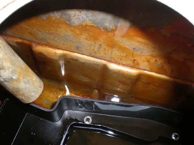

And this is what I found when I pulled the filter and finally pulled the tank for the last time... If your fuel looked like this it is coming from the tank insides...Not bad fuel from the local gas station, not a prank that the neighborhood kid pulled on you...This tank had been boiled out by a radiator shop and cleaned and lined by POR-15 gas tank liner...
And yes I thought my issues were from a load of bad gas and/or someone dropping dirt into my tank...

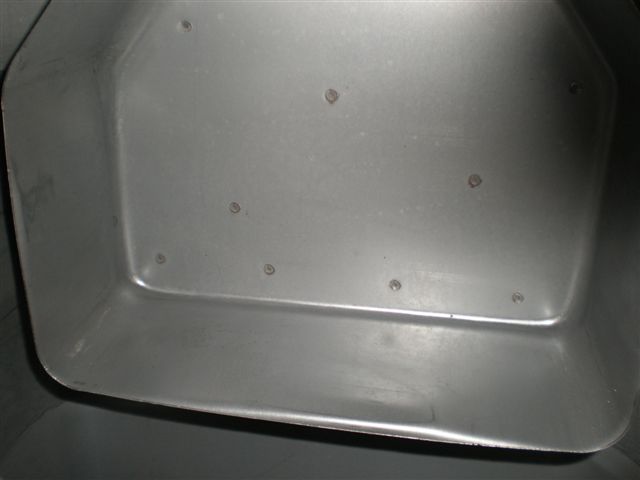

Is the tank pictured after the lining or prior to? Do you recommend just getting a new tank or having my old one lined?
Unfortunately that pic is after the liner was poured in...
I even bought a second used tank thinking that surely it wouldn't be bad too.. I was wrong...The liner I used I have seen do some amazing stuff but with our metal tanks there are so many bends and curves inside the tank that the liner apparently didn'tcover all of it and the rust actually formed on top of the liner after about 3 months...
After throwing away $75 for a used tank, $80 for the radiator shop cleanout twicw, $50 for the liner that didn't work I wished I had just bought a new tank in the beginning and not had to deal with this mess..
I bought this truck after it had sat for over 2 years with a half tank of gas in it... Actually it was more like varnish and rust...I had a dead fuel pump initially as well and by replacing the pump in the old tank even after cleaning it out I started a 3-4 month cycle of replacing fuel filters and dead pumps that finally ended when I bought a new clean fuel tank..
Hope you have a 4 door X since their tanks are a lot cheaper and more plentiful than the Sport tank...And they are still metal...:(
Look at the difference...Old tank vs new tank.........
