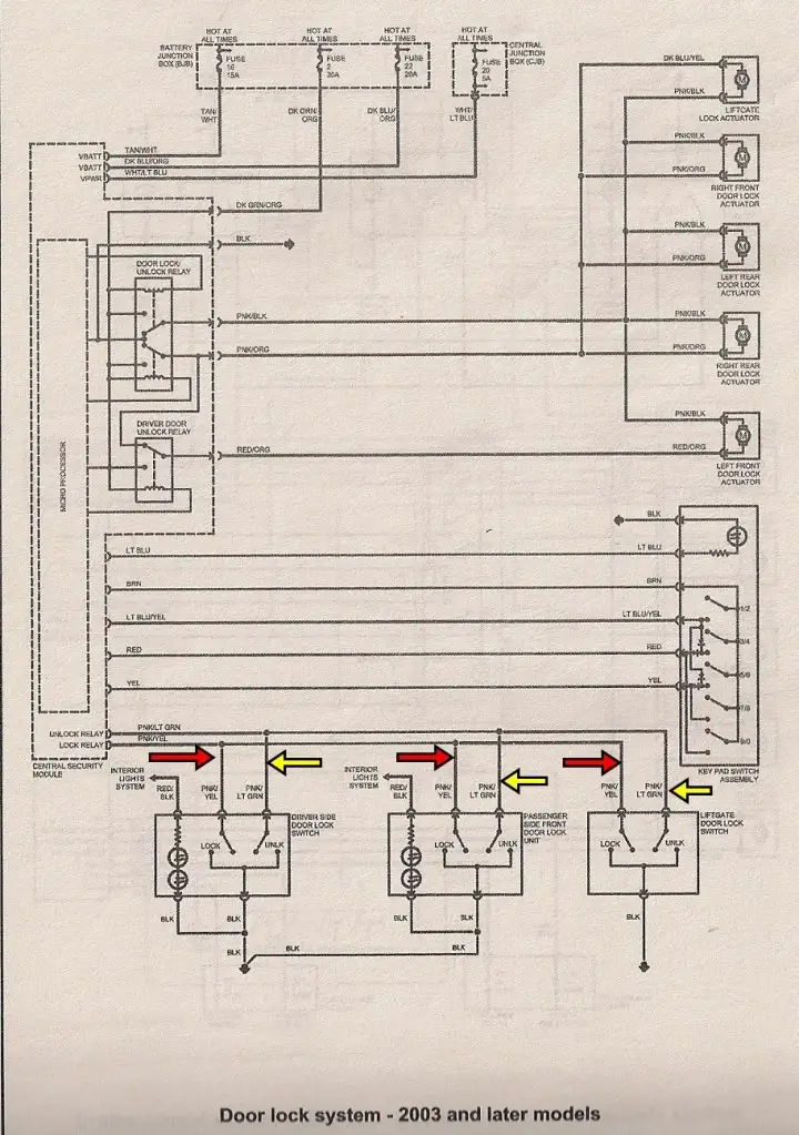

Hi guys I have a question I'm installing a alarm on my 03 explorer I'm just in doubt when it comes to to power locks does anybody know where I can find the wires and what color they are since my explorer came with stock keyless entry thanks everyone
Welcome to the forum!! :salute:
Here is the wiring diagram for the door locks. I apologize for the size, but I wanted you to be able to read it:
The lock wire is pink/yellow as indicated by the red arrows.
The unlock wire is pink/light green as indicated by the yellow arrows.
These wires go to the relays in the Central Security Module.
Hope this helps out. :biggthump
