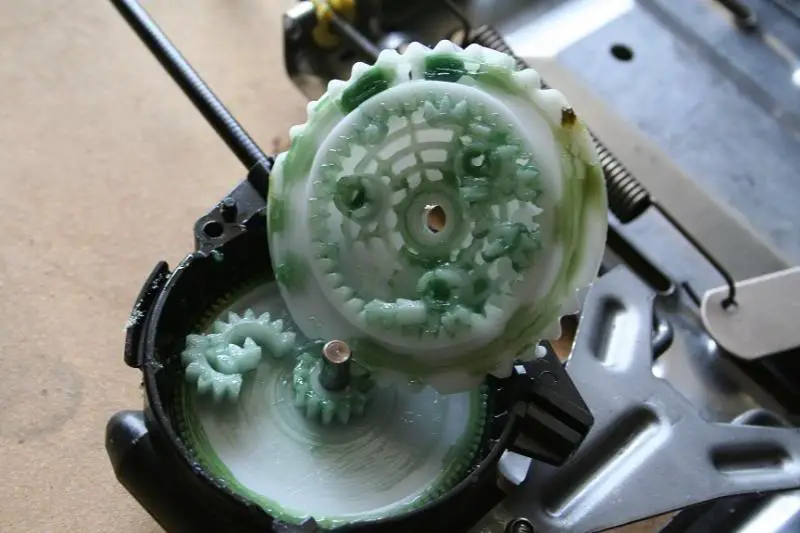

i had the same problem on my '06 EB. here's what i found inside the gear assy. i had already purchased a new assy ($90) so i have no idea where to find the planetary gears.
