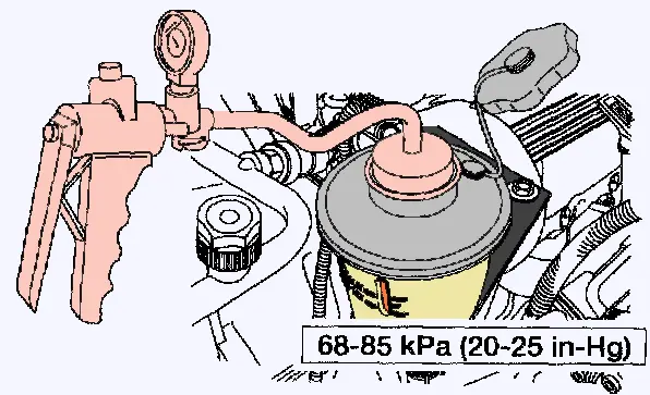

To bleed (purge):
1) Raise the front wheels and secure the vehicle.
2a*) Remove the reservoir cap and replace with a vacuum cap and vacuum pump.
2b*) Apply and maintain a maximum vacuum on the reservoir.
3) Cycle the wheels between both locks for a total of 10 times (1o times left, 10 times right).
4) Release the vacuum and check the level. Add if necessary.
5*) Apply and maintain a maximum vacuum on the reservoir, again.
6) Start the vehicle.
7) Cycle the wheels between both locks for a total of 10 times, again.
8) Stop the vehicle.
9) Release the vacuum and check the level. Add if necessary.
10) If fluid aeration persists, repeat as necessary.
11) Reinstall the reservoir cap.
12a) Apply approximately 8-12 lb·in of force onto and remove the nearest beer bottle cap. Deposit fluid into mouth.
12b) Repeat as needed.
* I have done a bleed in the past without applying a vacuum to the reservoir, so it may not be game-changing. I know some power-steering systems don't require a vacuum to bleed out the air, just a wheel cycle. However, the next time I perform one I intend to go through with this step to make sure it's perfectly thorough.

Great instructions Mr Dubya. I used the same procedure and it worked great. Any reason the Ford workshop manual and most tutorials say to pull the coil fuse and crank the engine while turning the wheel lock to lock? I didn't crank the engine because I was alone and didn't want to run the system dry. One quart of Valvoline Mercon V seemed like enough until it flowed clean.
I too am not sure what the logic is behind pulling the fuse and cranking the engine (relative to the power steeeing). I've never done it, and humbly took the liberty of not providing it in the instructions since I fail to see its rationale.
I suspect it may be one of those 'standard procedure' remnants left over from an old or unnecessary company protocol. Perhaps similar to trivial-ness of hooking up a dial caliper to your rotor when doing a break job ;) But, there may certainly be a sufficient reason I'm unaware of.
