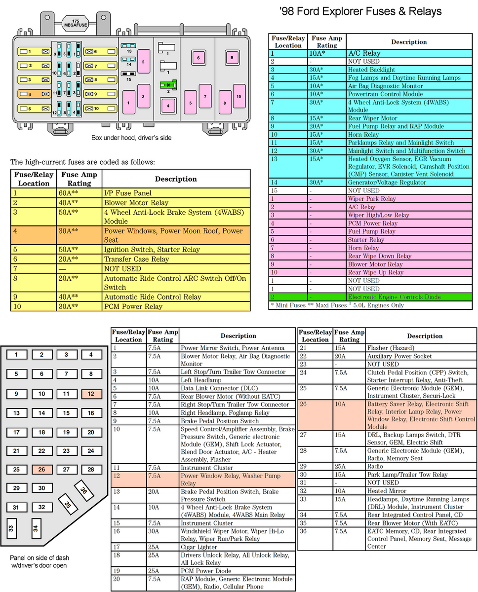

I'm sure there are 1000 posts about power windows going out, and feel free to just reply with that thread if you know how to quickly find it. For reference, I have a 2001 Explorer XLT and live in the Atlanta area.
None of my power windows will roll down. Thankfully the issue must have cropped up over the winter and they're not stuck in a down position. My first thought is the fuse, but I couldn't find a good fuse box diagram. Additionally, my wiper fluid (though topped off) will not spray on to my windshield, and in a Georgia summer I'm running into bugs left and right, so I can't clean the windshield while driving.
I'm wondering A. If the two issues are related (as in are they on the same fuse or do they share wiring?) and B. Should I expect a more complex repair other than a couple of fuses?
Not sure if it matters any, but a pin from my shifter cable came loose and was replaced recently. The issues with the windows and wiper fluid had been going on prior to the pin falling out, but I wasn't sure if there was something related to the steering column. If someone could post a quality diagram of the fuse box and or any links to threads that ended in success it would be a great help. Thanks ahead of time!
