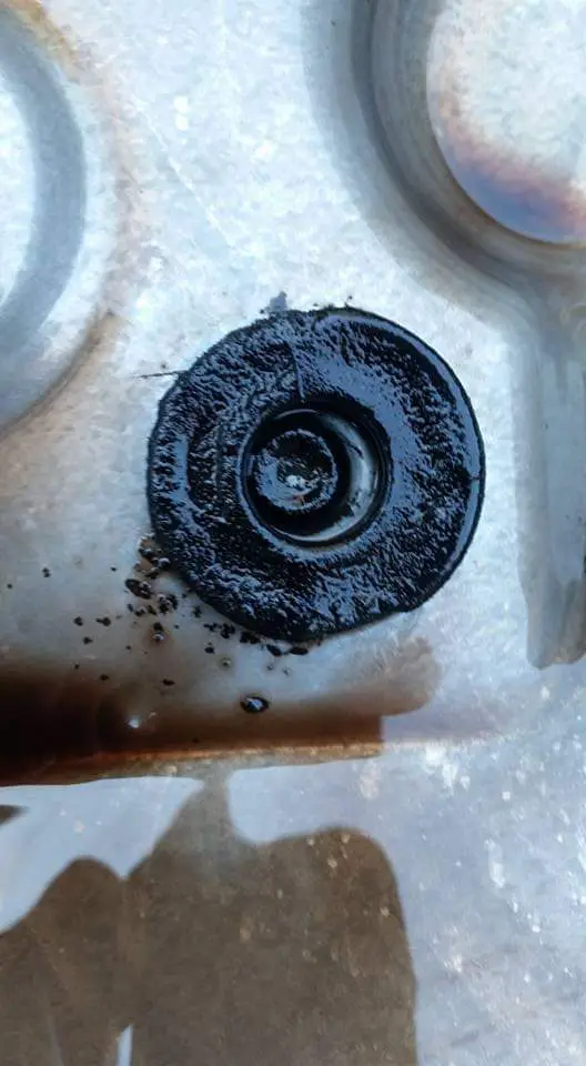

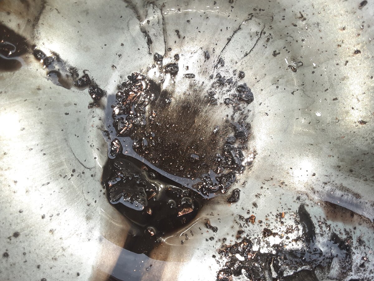

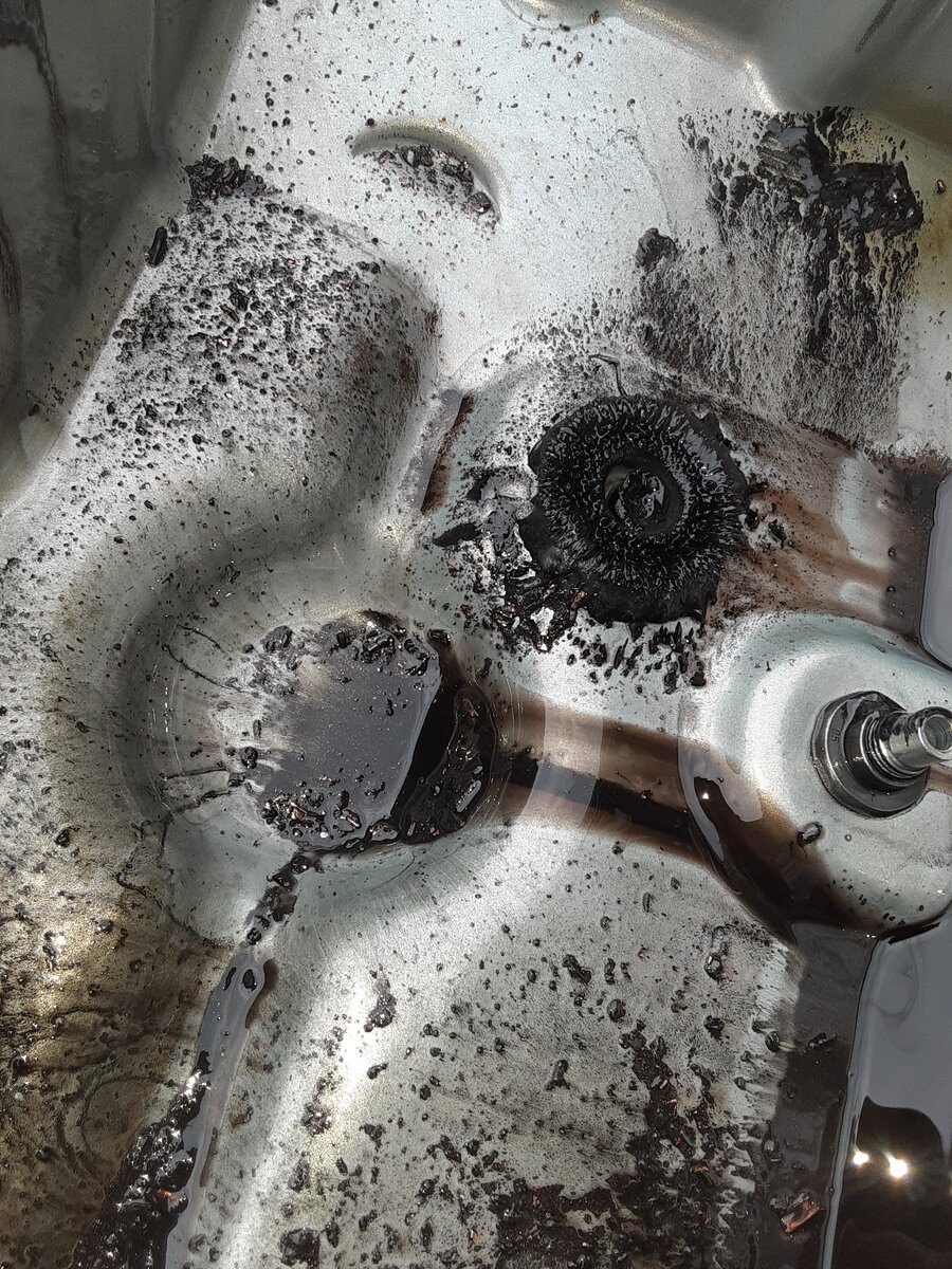

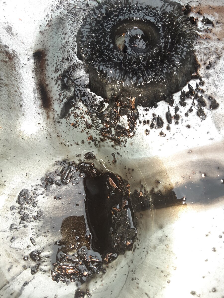

My question is if this is normal wear and tear on a used transmission I threw in a year and a half ago. While doing so I cleaned out the pan so this is all new material. Keep in mind I've been in four-wheel drive a few times been through one winter and have put about forty thousand miles on it.
I'm throwing code P0715 - Input/Turbine Speed Sensor A Circuit
The fluid was black when I drained the pan and disregarding the normal terrible smell it also had a burnt smell to it.
In the pictures it shows some copper material and what looks to be fine bits of metal (paste) around the magnet. I only need this transmission to last another winter. I know it's not in the best of shape but how long you think I got with it? Any quick opinions are helpful feel free to school me if you'd like. :)

Seems like an AWFUL amount of sediment for 40k.
My advice is to drive it like a 90 year old grandmother going to church and it might last through the winter. The 5R55 transmissions aren't all that reliable and yours looks like it could go down for the count any day.

I agree. The magnet sludge of course is "normal", but I kind of see bits of thrust washer in there...

Not normal on the copper looking pieces of material but the magnet is normal with small dark material.
Tore it down, rebuilt a few times, replacing and upgrading valve body and pump. Trans fluid mod and stick wouldn't budge. Tore down again FINALLY one way plastic sprag was broke apart. Can't tell unless you unseat it and check. It's yellow and at the front of the trans. Everything must come out to get to it. Make sure it only moves one way when you reassemble. Tell you what I can take him apart put them together with my eyes closed with nothing but a jack to get it out now though.
