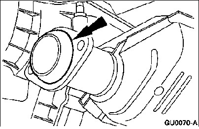

I can't swear on the part number, but if it looks like this I'm pretty sure it'll be right.

The guy at Ford told me that was the gasket that goes before the cat. I need the gasket that goes after the cat. The one I got is oval in shape and flat .
If your's is flat, it must not be right. Talk to another person, there is NO gasket before the cat. Before the cat there is another cat and they are welded together, so no gasket.
Maybe the guy is dislexic (sp?). A flat gasket sounds like the one before the first cat, between the y-pipe and the first cat. Make sure he knows you mean the one after the second cat, between it and the muffler assembly.
That picture is from a '97 Ford service manual, and is showing the exact gasket I'm speaking of. The one on my '95 was exactly the same, so I doubt your '96 would be any different.
