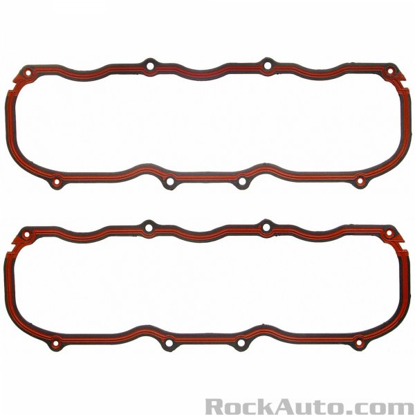

Oil Leaks: OHV is notorious for oil leaks on BOTH valve covers, closest to the firewall, on the bottom 45 degree angle.
Engine is slightly tilted upwards, oil collects there, and leaks.
Only 8 teeny-tiny "M-6"bolts hold on the 7-10 lb valve cover...
Eventually I replaced the 8 valve cover bolts bolts with metric (M-6) all thread studs I cut to length and bottom out in the heads, bigger diameter washers to spread out the pressure, and nyloc nuts to resist engine vibration.
Don't use any other Valve Cover Gasket than Fel-Pro PermaDry Plus #VS50368T, in combination with a liberal application of Permatex Ultra Copper #81878 on BOTH sides of the gasket, on ultra clean head surfaces.
Also, get under and HAND TIGHTEN all of the Oil Pan Bolts - I had to do this once around the 80,000 mile mark.
Engine vibrates, and the cast aluminum oil pan weighs quite a lot and slightly loosens the oil pan bolts.
The OEM oil pan gasket is very high quality, and if you overtighten you will bugger it up.
Last, you can check the area surrounding where the oil filter mounts for oil leaks.
I had to remove the oil filter mount and replace the O rings.
Only 6 tiny bolts hold on the 7-10 lb valve cover.
Eventually I replaced the 6 bolts with metric all thread studs I cut to length, bigger diameter washers to spread out the pressure, and nyloc nuts to resist engine vibration.

Re-check your valve cover bolts - you'd be amazed how much they loosen in so short an amount of time - especially the bottom ones.
Realize that once there is oil in the valve cover bolt mounting hole in the head, you're fighting an uphill battle UNLESS you do a deep cleaning with brake cleaner, q-tips, and compressed air in each bolt hole.
Also - if you used a CORK valve cover - it's a losing battle - the Valve Cover Gasket listed above is the BEST out there for this engine.

Been dealing with this engine for over 15 years, and oil leaks are my pet peeve ;)
This engine was designed in Germany in the 70's - overall it's a keeper BUT it has some small shortcomings.
The amount of VC Bolts is too few, and the diameter of the bolt is too small, for the weight of the Valve Cover and the amount of Engine Vibration.
Add to it the tilt of the engine that causes pooling of the oil in the rearmost bottom portion of the valve cover - well, you get the picture.
On BOTH valve covers, the bottom bolt closest to the firewall, is the first bolt to loosen.
Once oil is in the mounting hole expect to be tightening it at least every month.
After 14 years of thinking about it, last year I went to my own design; I threw out the teeny tiny Metric M-6 valve cover bolts and went to bottomed out M-6 studs I cut to length from all-thread, bigger diameter washers to spread out the load, and nyloc nuts.
After 14 years of this I went to my own design - studs, bigger washers, and nyloc nuts.
