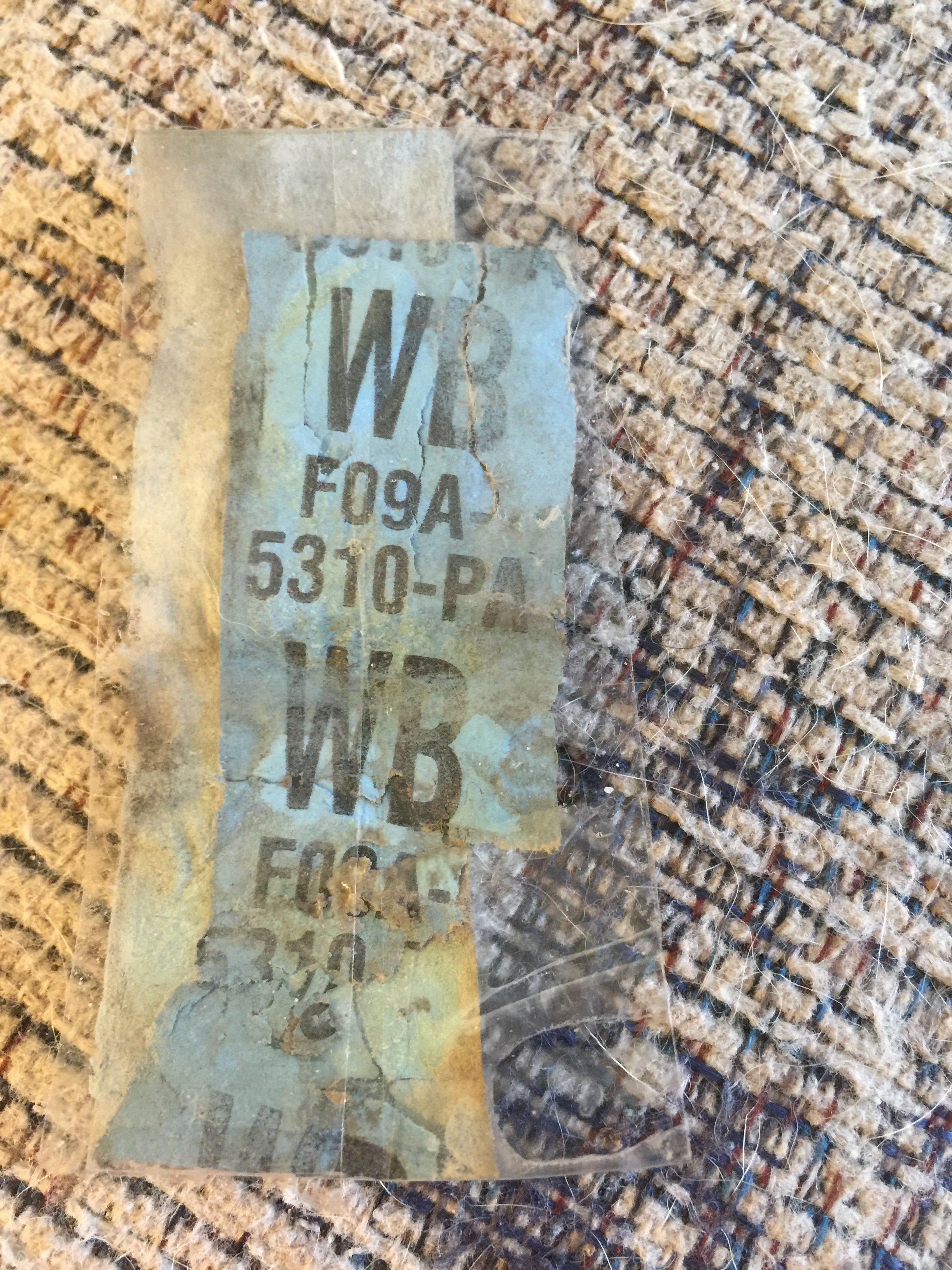

Brooklyn Bay you know I've been getting beat up with coil springs for my awd Aerostar I found this excellent shape parts tag. I googled the number Guess what odd truck this part gos to.
1980-1985 ford F-100-350 truck? How can a 1/4 and 3/4 ton truck use the same spring. I understand it's the front so it's only carry the nose and block. But how about handling ect....
Any thoughts
