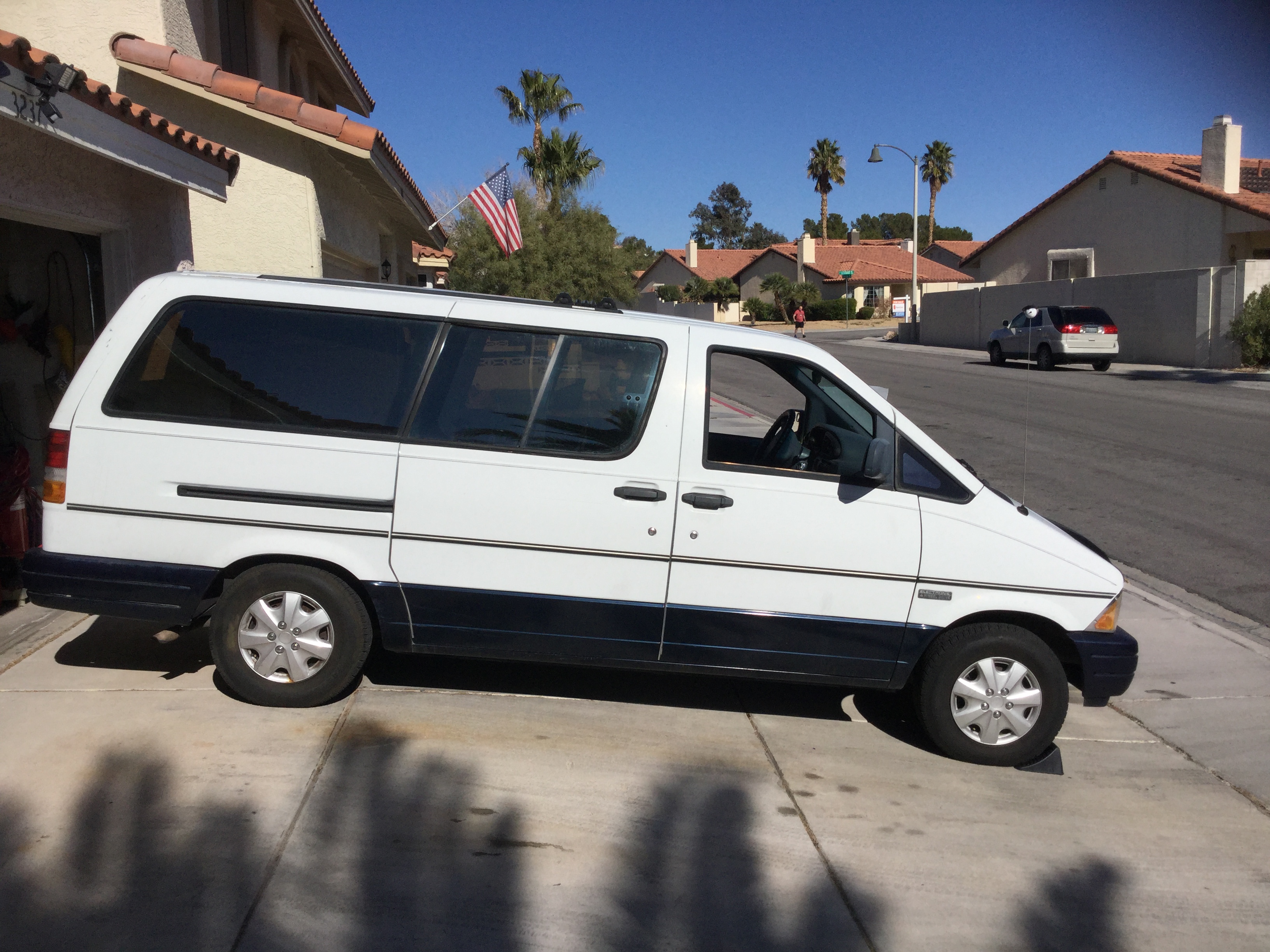

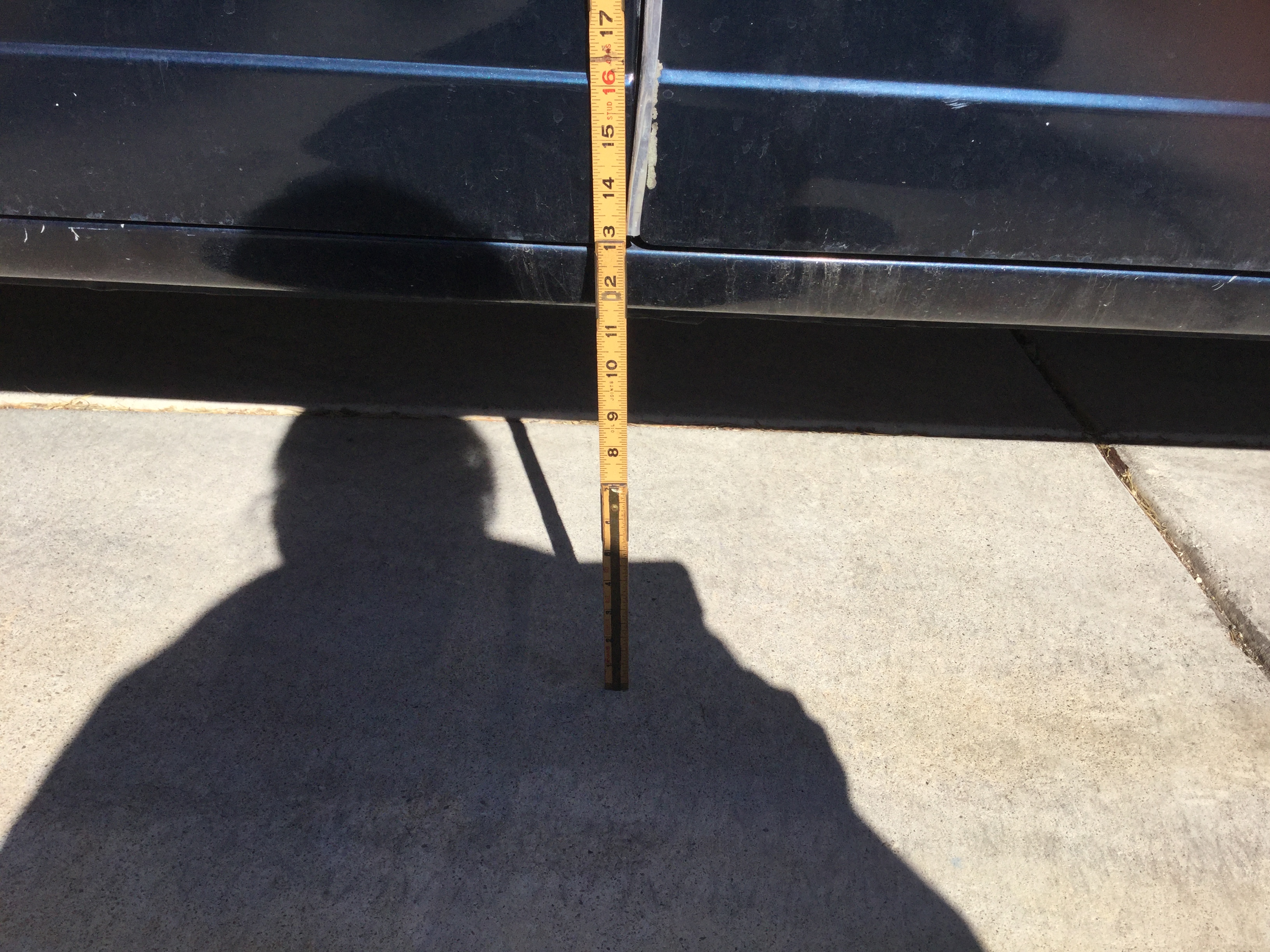

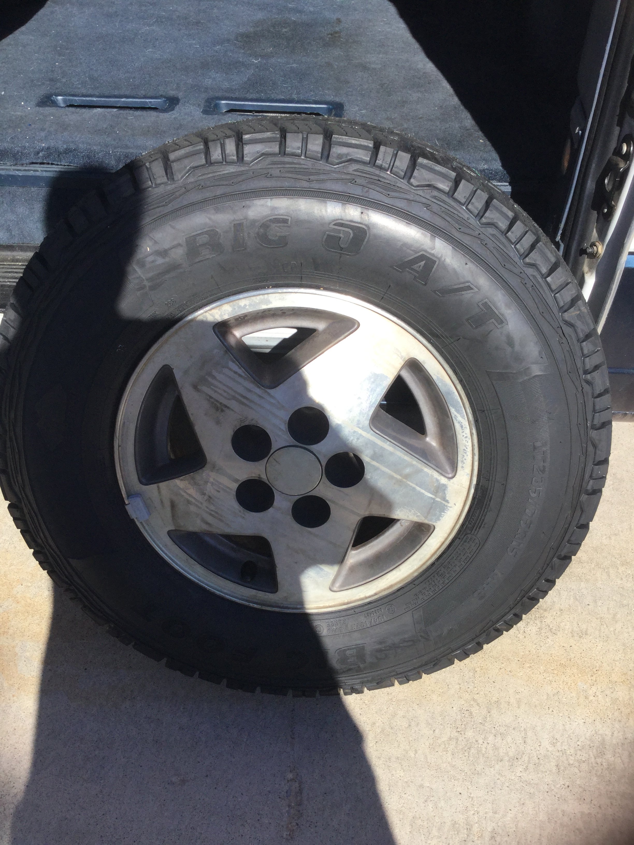

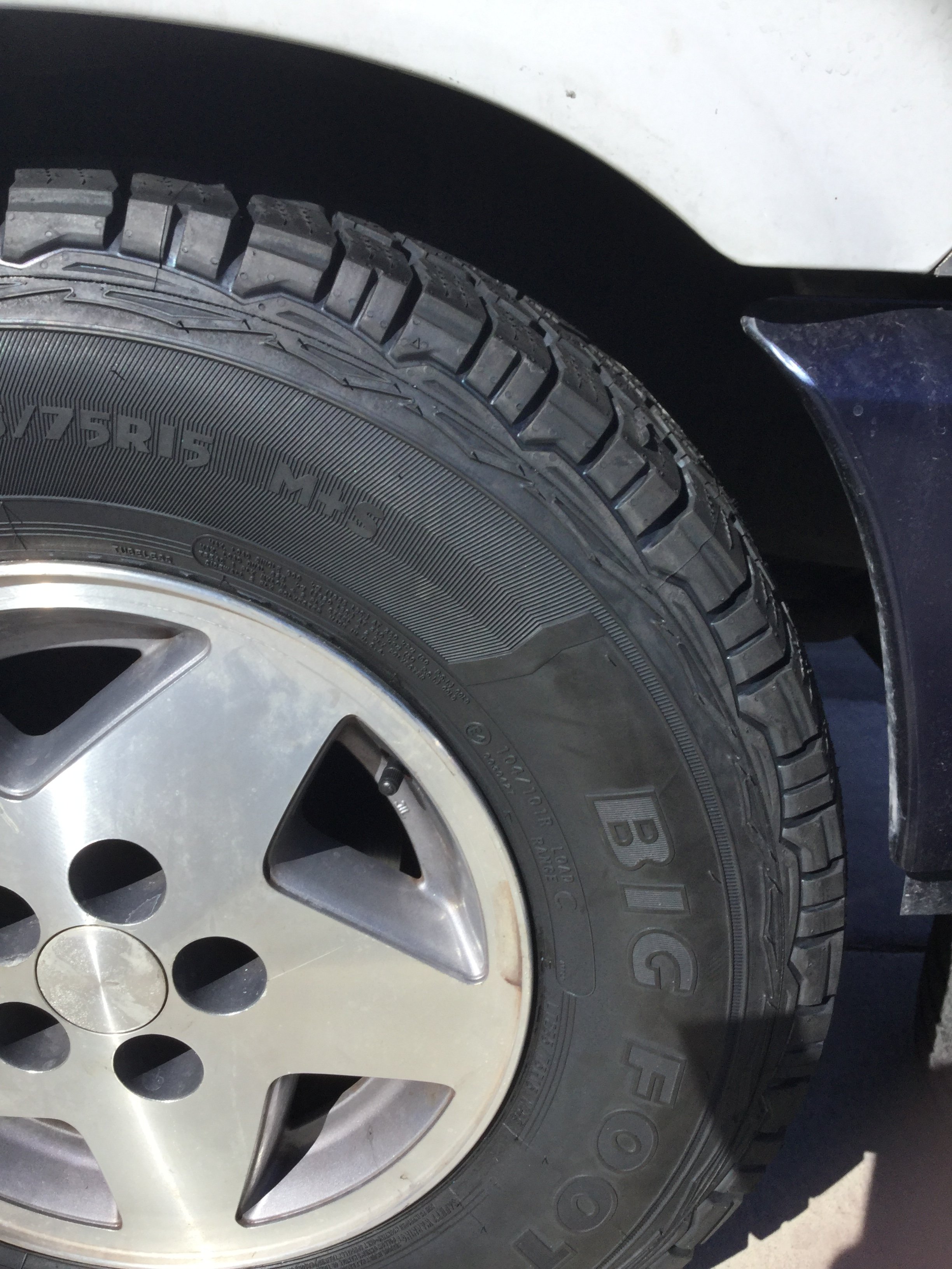

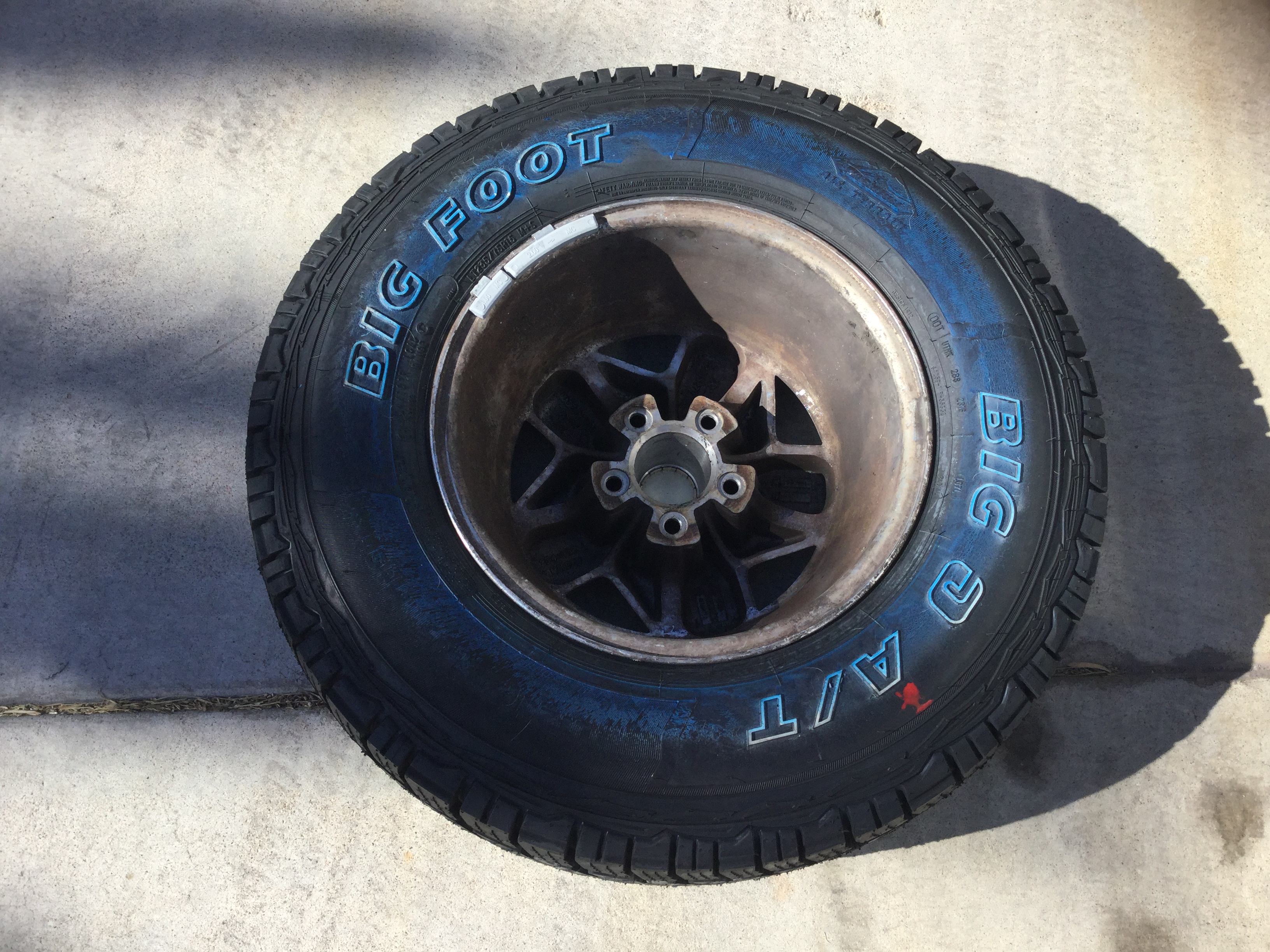

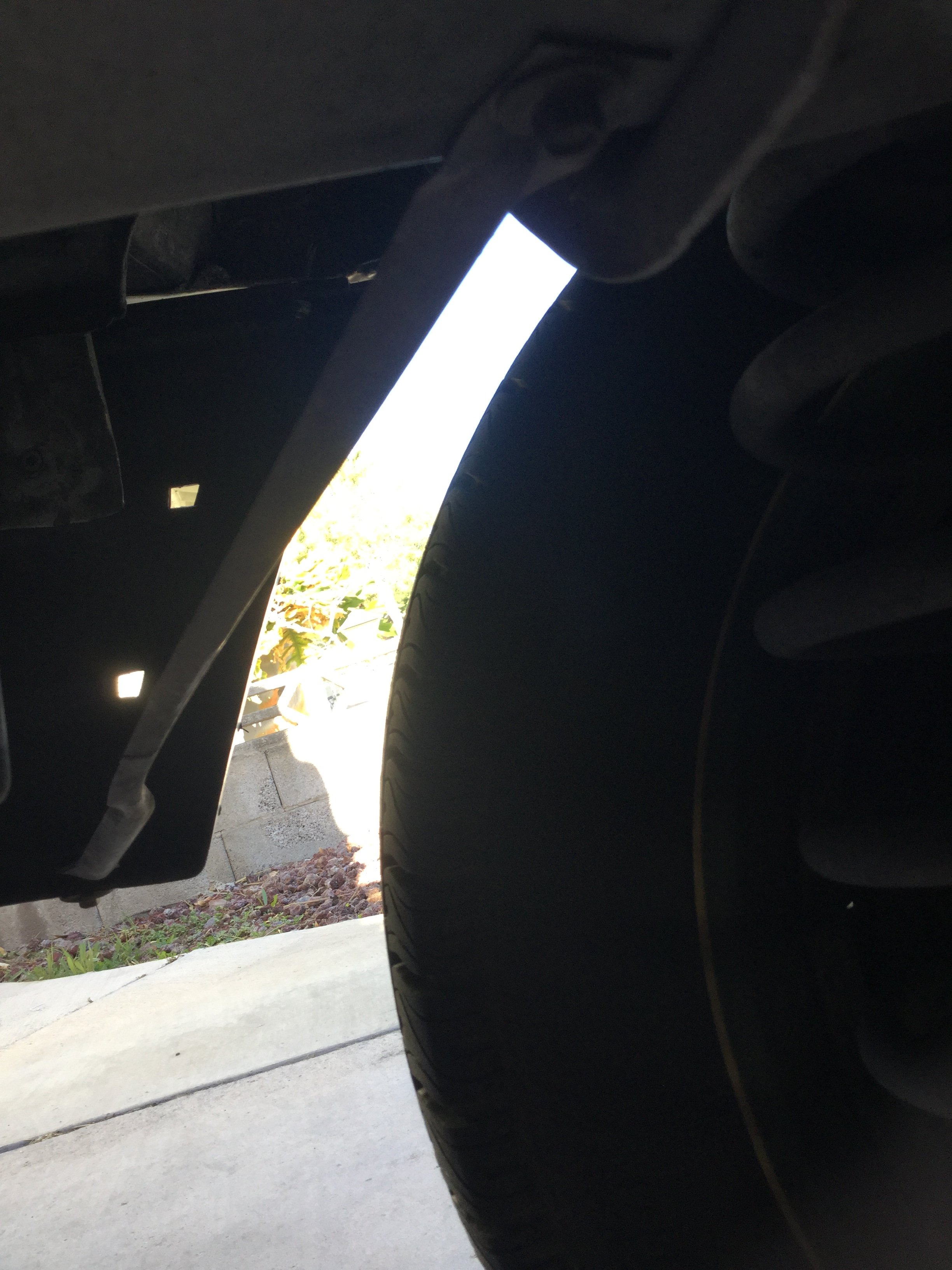

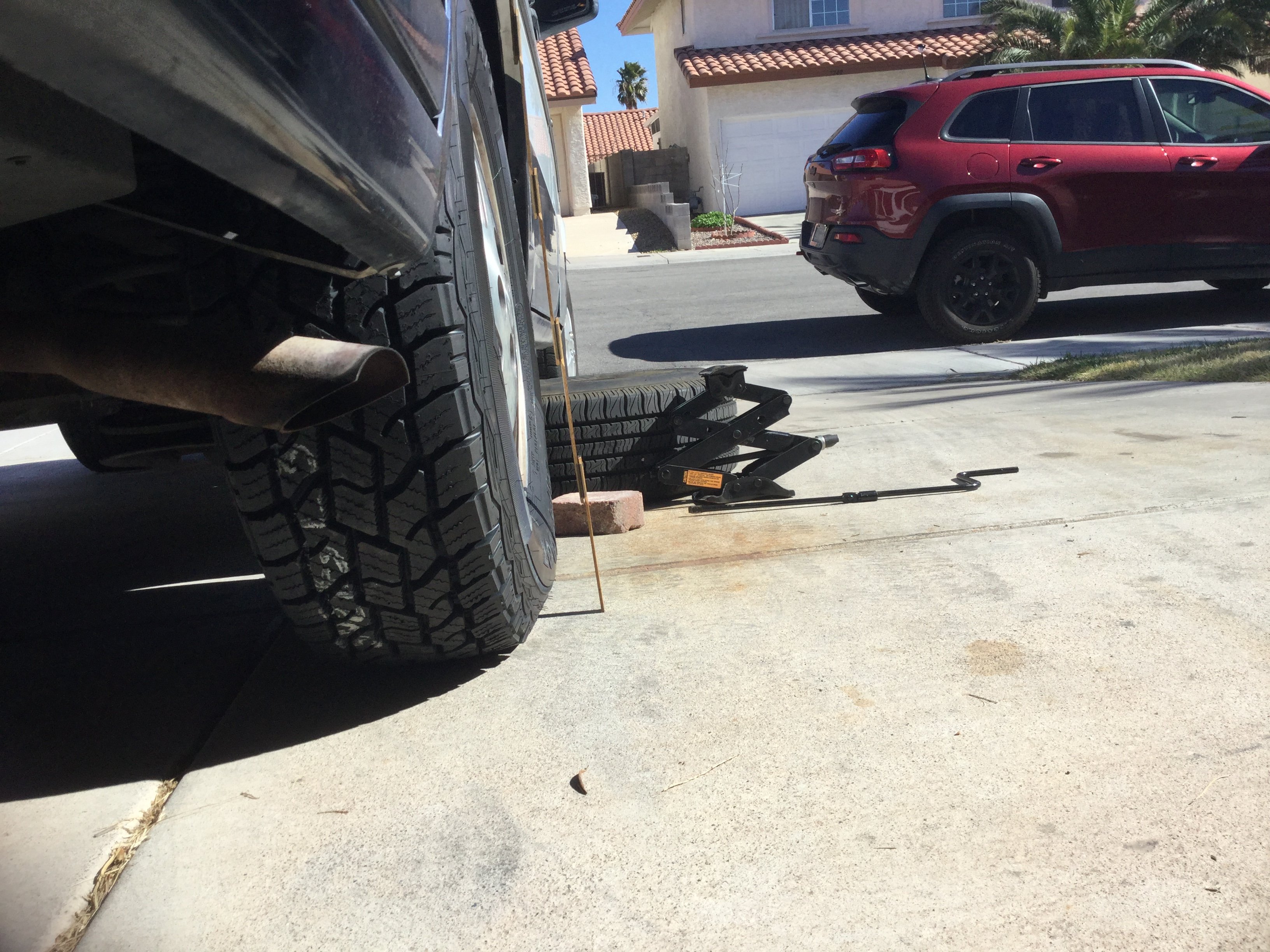

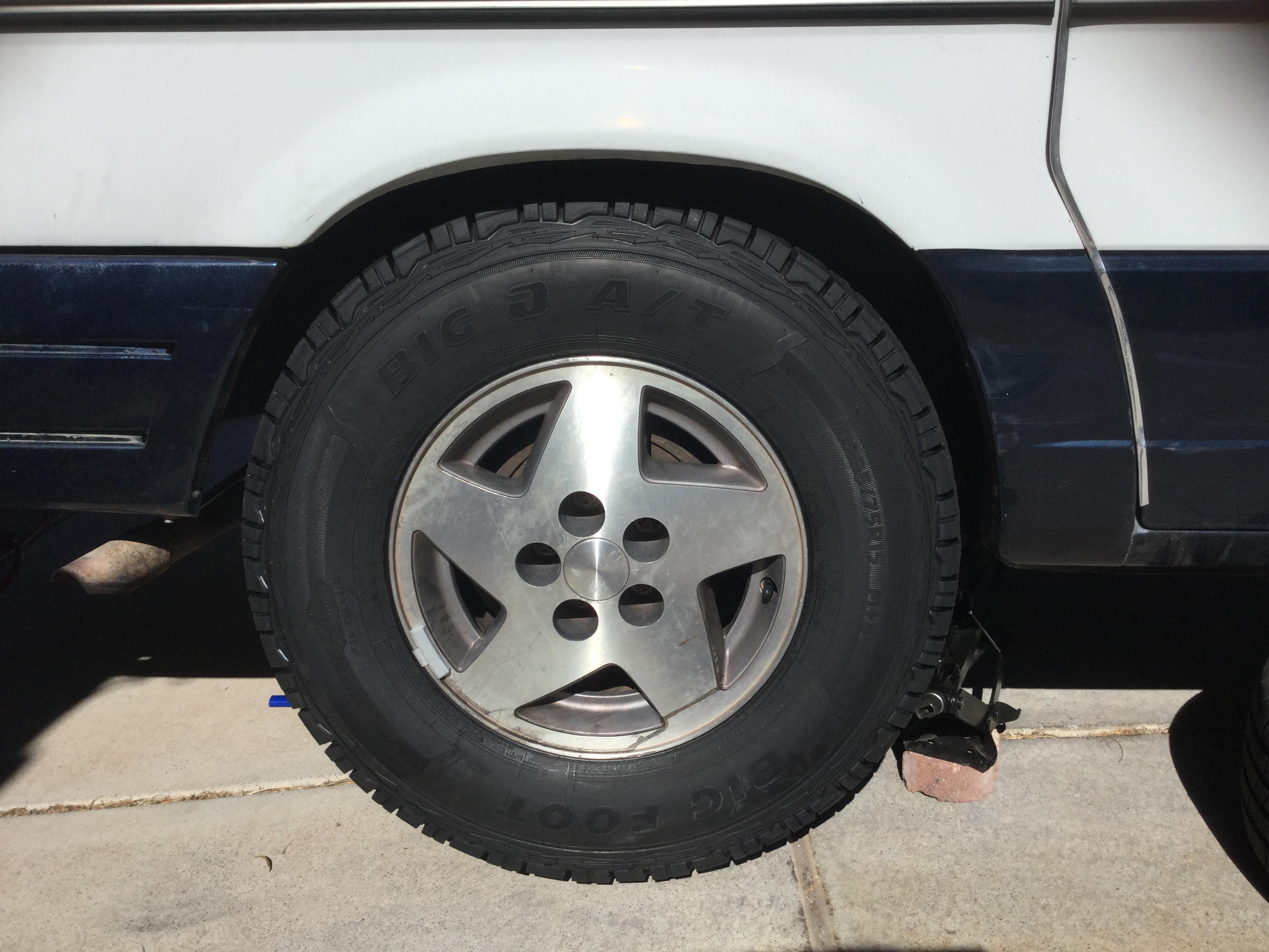

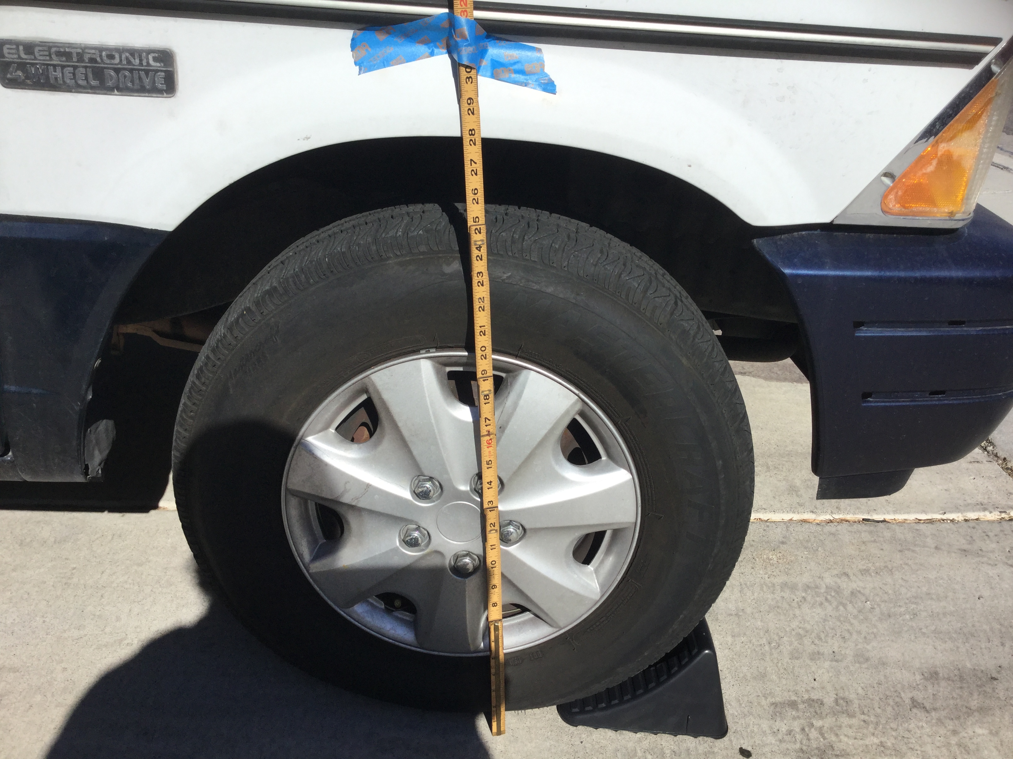

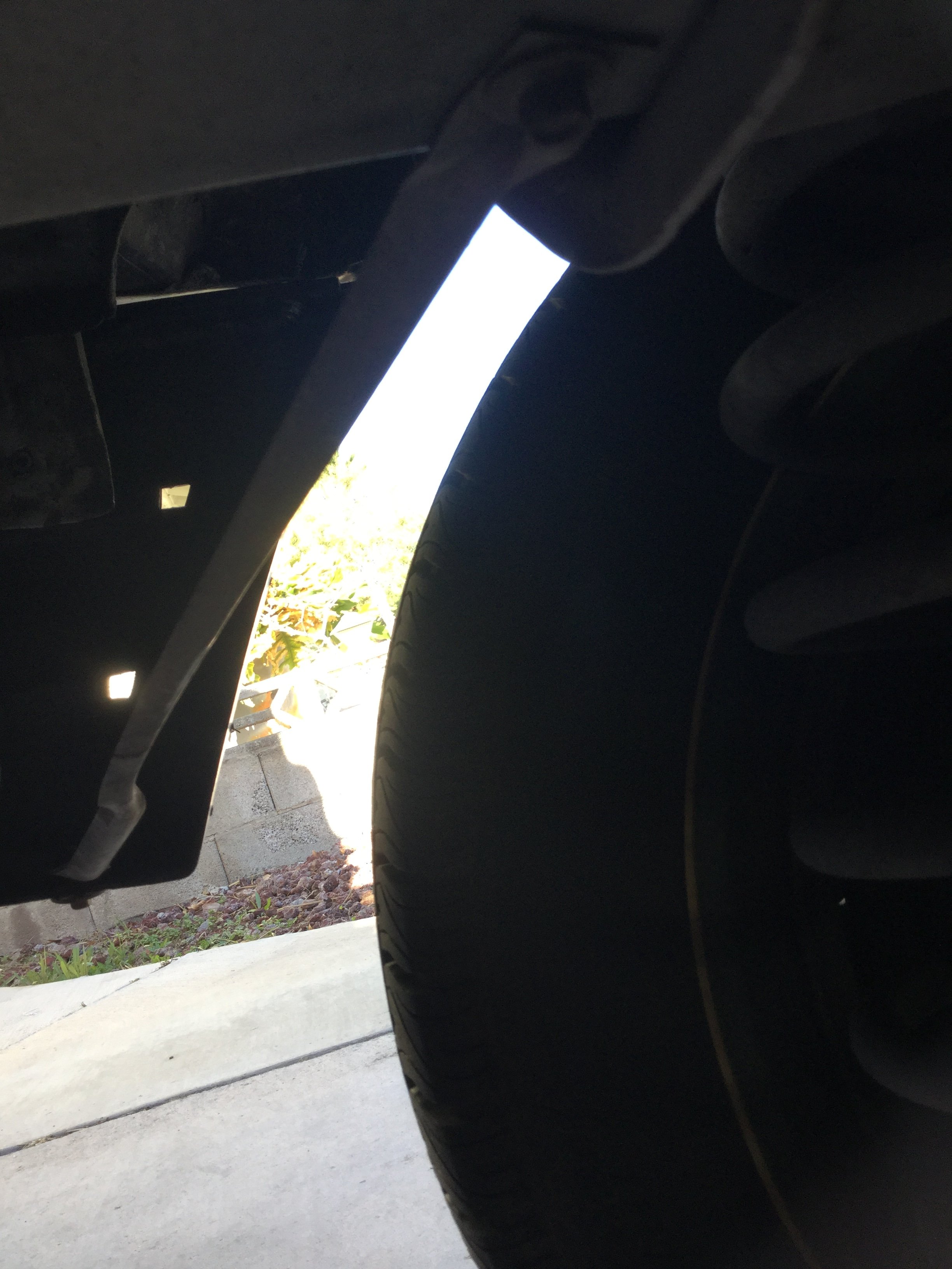

well they said it couldn't be done.they said major lift is needed to install monster meat on an aero star. Can it be I have an awd aerostar and it has a factory lift I don't know. Our guru Brooklyn and Josh p will have to chime in. I went from a 215-70-14 all season to a big o big foot mud all season t/a truck tire 235-75-15. Here's the photos. No trimming or cutting my only thing that need to move was my passenger rear back fender brace. It must have been bent it's touching on the tire. But drivers side ok. I'm shot and need my wheel chair rest. I'll post as many photos the site allows. That's to Josh who supported me in this crazy idea. I got 2" of ground clearance. Despite the math. My spring purch was just under 7" before after its -10".
