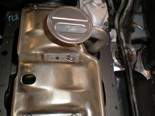

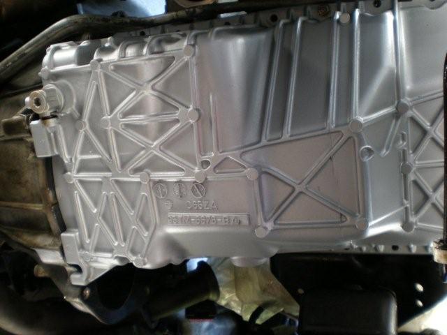

I don't think the pan can be pulled with the engine in the truck or at least lifted up a bit. I could be wrong though.
Only a V6 view but....
These pics show the unobstructed view of the bottom end of the new engine and the oil pan I attached after installing the shortblock in my 99 Sport...If the 97 looks anything like that I think it is possible to drop the pan with the engine in place...
Hmm maybe it's the V8 I'm thinking of?
