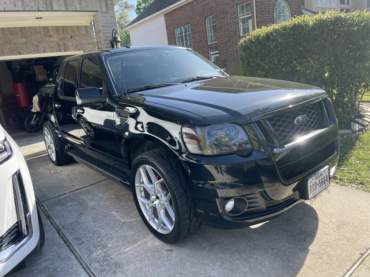

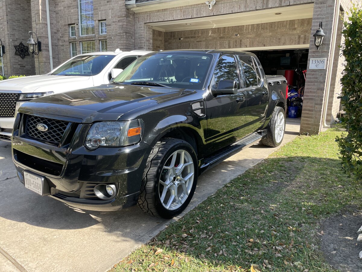

I have a 4.6L V8 3V in my 2010 explorer sport Trac Adrenalin.

Would love to see more pictures of the sport trac.
Guess it's true what they say about Texas!
