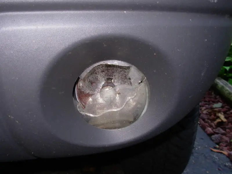

Hello everyone,
I have been following this site for a while and thought it was finally time to join. I have a question that I hope I can get some help/information on.
My driverside stock fog light has seen better days....
and before you ask, yes it does still work.
My questions is does anyone know how to replace the whole assembly?
Any pictures or diagrams would be very helpful. :D
im getting halos, i cud sell you my old ones if you wanted em..
Thanks for the offer skia4life89, but I am still hoping some have a picture or diagram on replacing a fog light.
there are a total of 4 bolts you need to take out. 3 of them are easy, 1 of them is behind some panel and it makes it difficult to get out. after you get the bolts out just unplug the factory harness and pull it out. its pretty self explanatory. once you get under there you can see the bolts you need to remove.
