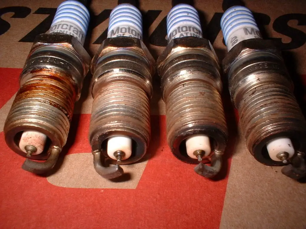

Another thing to look at to detect a blown head gasket is the white part (porcelain?) of the plug.
Notice the red color spots on the end of the plug on the left? This plug was in the #1 cylinder that had the blown gasket.

no I've not had anything like that. so I don't think a blown head gasket would be the problem. like I said, no pressure in radiator, no blowby, not sucking paper in the exhaust, and crompression looks good, so I don't think a blown head gasket would be at fault. keep giving me ideas, I really do appreciate your trying.
