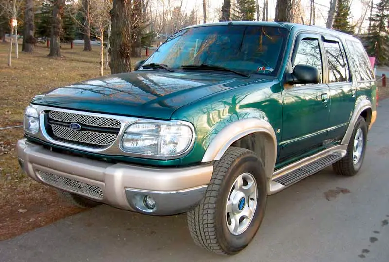

The bumper is standard issue on the '99 I presume. The Eddie was bone stock when I got it. I'd love to know the story on the past owners. The Eddie was getting about 5,500 miles/year on it and it's still got the original windshield. Windshields don't last long here with the gravel we use in the winter. I ran a background check on it and it always got maintained. Just someone that doesn't drive a lot. I just went over 36,000 miles (60,000 km) this morning. Not bad for a 7 year old vehicle, and especially for an engine with the reliability of the 302. I've since filled her up with Amsoil everywhere I can. I expect the Eddie to last a long while. :)
The Speed Grilles were salvaged off my Sport which is about the only thing that isn't stock on that grille. in the photo I've since added a Explorer Express Airdam to the front end (few months back). No photos yet. It was painted to match the gold trim (bought it that way, the guy also had an Eddie Bauer). Colour match was close, but not perfect.
I'm pretty happy with this Explorer. It is the 4th one I've owned (had a '93, '97 and a '00, all Sports). First one had OHV and other two had SOHC. I definitely prefer the V8. :) I scored the extra 2 doors not too long after my son was born. So much easier to get him in and out. The 2 door was a pain! I'd still be driving the Sport if I didn't have that issue.
EDIT
I see you're in SD. Get yourself some Torquemonster Headers! They're made in San Diego and the guy who runs the company is a great guy. I'd kill to be so close. Would save me a ton on shipping and duties etc.
