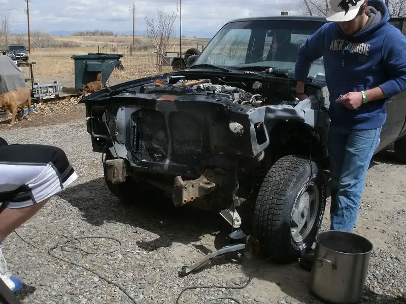

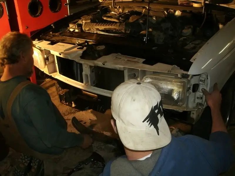

Chris, myself and Greg discussing the project. This is what we started with Wednesday afternoon

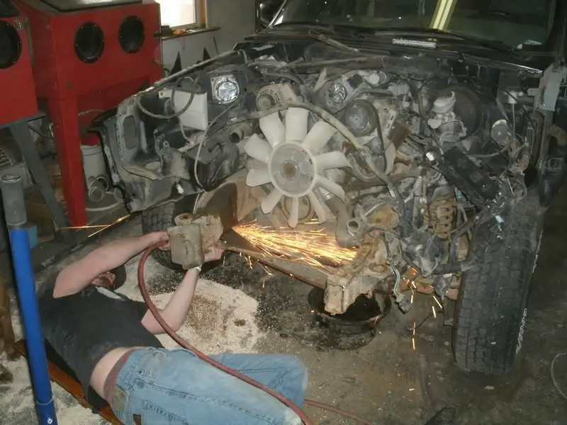

Showing Chris where to drill out the spot welds that hold the front inner fender/radiator support in place.

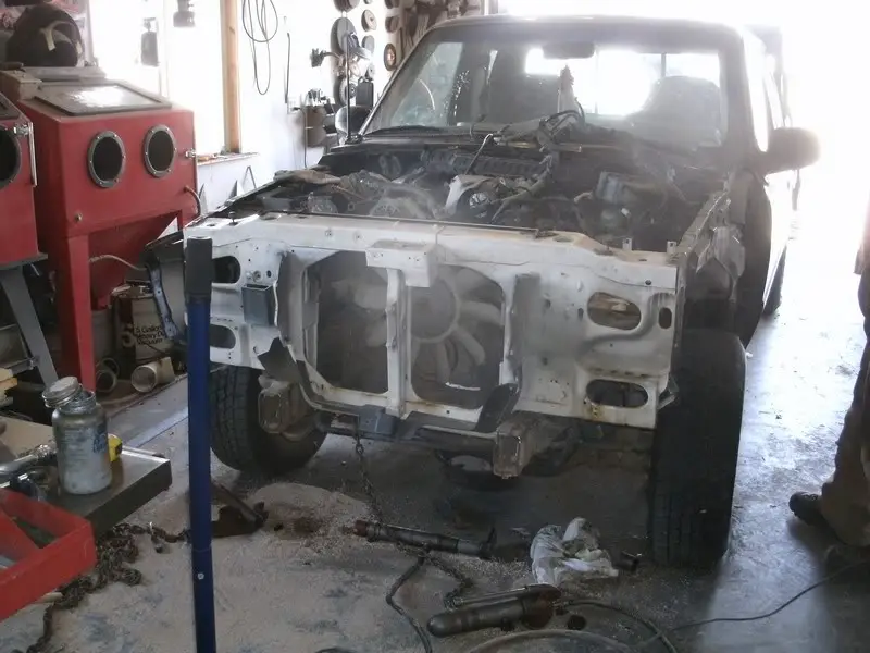

With the front sheetmetal removed we had to remove what was left of the crossmember and swaybar.
Thursday, we made the 2 hr trip to Basin, gathered the parts scored a set of manual hubs from an Explorer and headed home. the frame horns were bent in a little so we used the porta-power to get them pushed back in place.We then started replacing pieces starting with the inner fender/radiator support.
With the support tacked in place we installed all the front sheetmetal and double checked the fit, when we were satisfied with the fit we removed the sheetmetal and welded it all in, then put all back together...again.

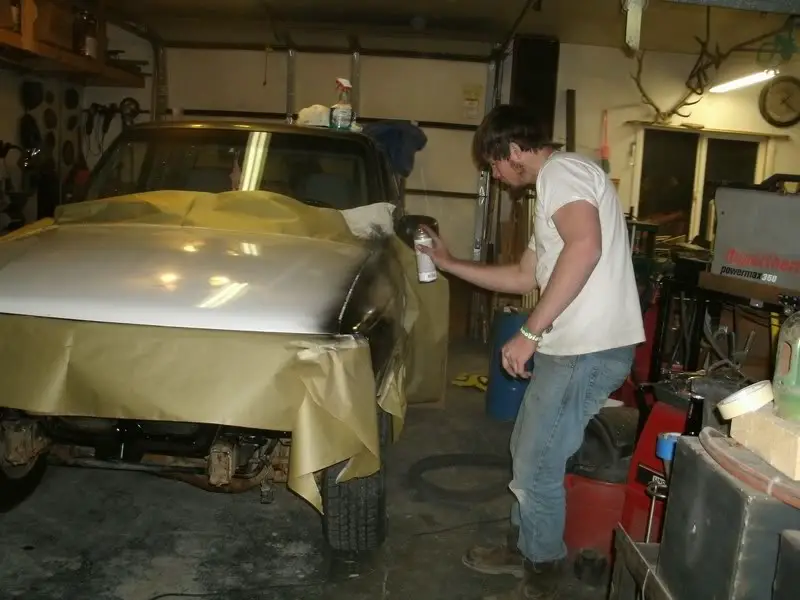

We're planning on doing more bodywork and giving it a camo paint job similar to my Explorer later this year so until then Chris gave it a quick rattle can paint job, he was painting at 1:00am Saturday.
