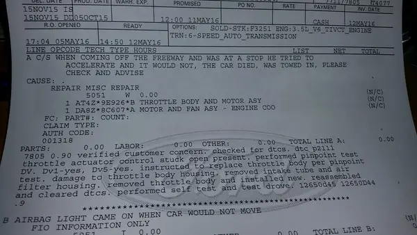

Did they list a part number for the fan assembly on your paperwork? We have been trying, without any luck, to get the part number to see if it differs from the original.
Peter
Fans replaced, PN DA8Z*8C607*A MOTOR AND FAN ASY ENGINE COO
The part number in my paperwork is DB5Z*8C607*C Motor and Fan ASY - Engine COO
An Internet search on that number shows 2013 MKT/ Flex/Explorer radiator fan/motor.

Well I'm going to stop reading posts that talk about problems with the 2016 Explorers. Last night my fan started to squeal, just like others have talked about. Now I am really regretting reading about the throttle body problems.....will that be next?
