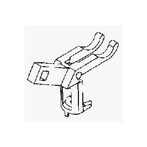

Valve spring compressor
It takes a special (and expensive $160) tool to compress the valve spring on the SOHC V6 and only one valve can be depressed at a time.
T97T-6565-A

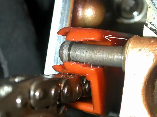

There is a slot in the upper end of the traction side of the guide. A positioning post keeps the guide in place as shown below.
Grab the end of the guide with your thumb and fingers and try to pull it upward. The vertical movement should only be about 1/16th inch. If it moves 1/8th inch or more the guide is probably broken lower down.

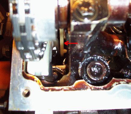

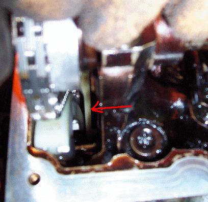

The photos below attempt to show the lower section of the guide on the traction side.
Follow it down with your finger reaching as far as possible and then attempt to move it sideways. If it moves it is probably broken. You won't be able to see much on the slack side because of the hood and the heater blower box blocking your view. I tried to use my camera and also a mirror but was not very successful. Try using your fingers to feel for any breaks. The photo below by CDW6212R shows what you are trying to see.
