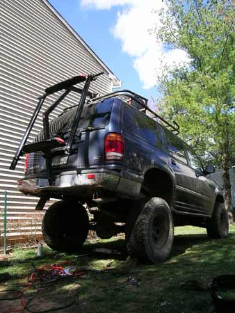

Below was my Explorer with SOA, WAR-153s, and Torsion Twist at the front.
Even a fully loaded 14-bolt GM 1-ton axle sitting in the cargo area of the Explorer came nowhere close to getting the vehicle back to level.
