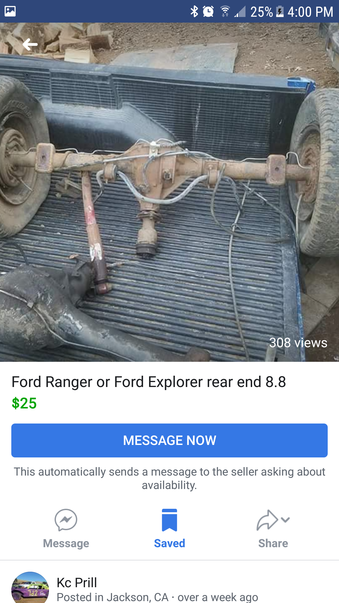

I stumbled across this and it looks to be a ranger diff by the leaf perches. Anyway to identify what year it came from possibly? Maybe 99 up since it appears to have a speed sensor on top?
I havent looked at it and im guessing he hasnt either. May just buy it just because its sellable if i cant use it
