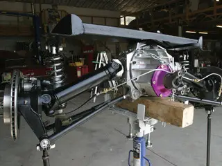

EDIT: The pic of the independent is one nice Ford 9-inch center section.
