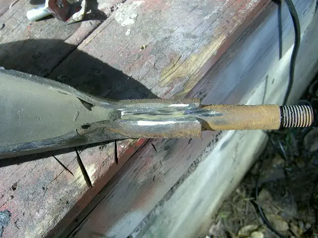

Getting ready to modify arm for larger rod. The stock rod is about 7/8" dia.

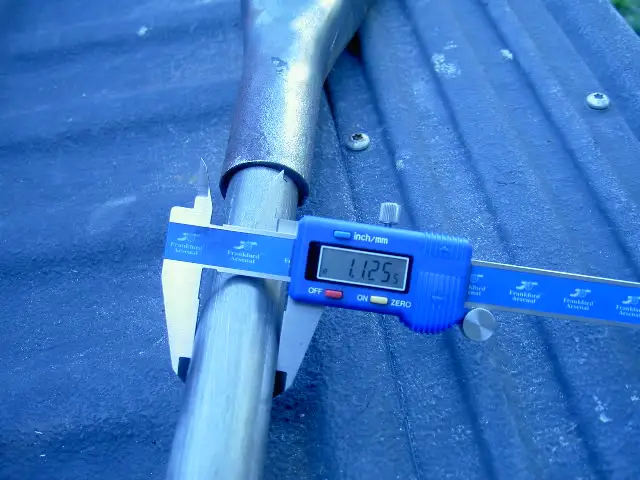

Here is the new longer rod. It is 1 and 1/8" dia. solid rod and threaded at the other end and threaded end is larger then the stock threads also.

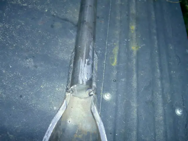

Here it is welded in place. Had to open up arm and cut a little off the edges to accept the larger rod. This will be boxed in and welded all around. I'm thinking of modifing the stock brackets and moving them back. I want to keep the same angle on the stamped arms so not to change the camber/caster alinement. May have to cut and turn the stamped arms or bend the rod. I've never done this so I have a lot to learn. Be a whole lot easier just to buy a set of longer arms. But that just would'nt look right after doing so much other stuff on this project myself. May turn out I wished I'd had LOL
