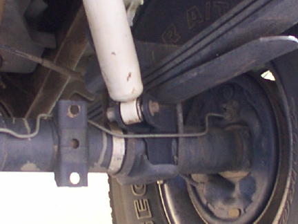

The way mine is set up I have stock length shocks and it moves just fine.
This was posted on page 11 of Boomin's getting a sex change. Does anyone know where I can get a set of these Superlift bolt on SOA plates? They look like they would line the rear end up the easiest. Well, that and the fact that I don't know how to weld. :rolleyes: Which is also gonna bring up a problem when I go to install the front shock mount reinforcements...
