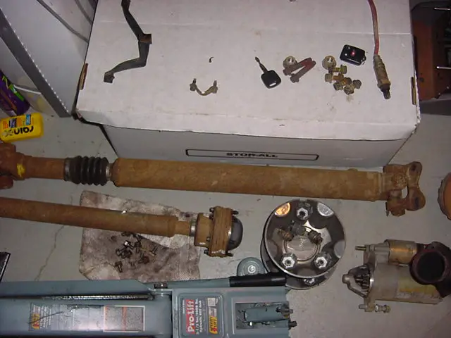

that makes sense. there should be no difference in length from the transfer case to the front differential. with the sports, only the rear driveshaft is shorter than the 4-doors and it seems like it is recommended to lengthen them.
so either way, your going to have to think about your rear driveshaft, unless you can use this mystery driveshaft 'trick' in the rear as well.
looks like you would be saving money on both the front driveshaft and the t-bars at least.
dont forget about the superlift shock problem as well. a lot of people had this problem. your paying $300+ to get rid of your t-bars, and get some coilovers. sounds good to me.
but then again, who knows what kind of money you have to fork out to make it fit if it doesn't.

I don't think the driveshaft trick will work on the rear. I don't remember cause it's been awhile but does the shaft where it bolts the transfer case look the same on front and rear shafts?
no it doesn't. the front driveshaft has a CV joint at the transfer case. the rear driveshaft has a U-joint. anyway, the diameters of the shafts are much different.
haha, using my newly elite skills and access to a digital camera:
Yeah, our piece definately won't work on the rear driveshaft after reading that and seeing that photo.

so your 'piece' is a spacer that goes between the front driveshaft cv joint and the transfer case?
yeah, it's just a machined piece that you slip into the joint and it allows some extra clearance from the boot. At the angles that the kits force the shaft to it rubs on the boot and destorys it.
