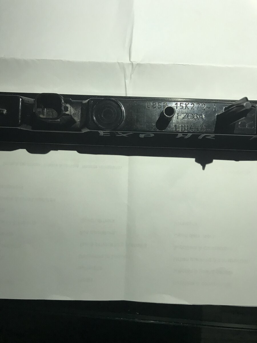

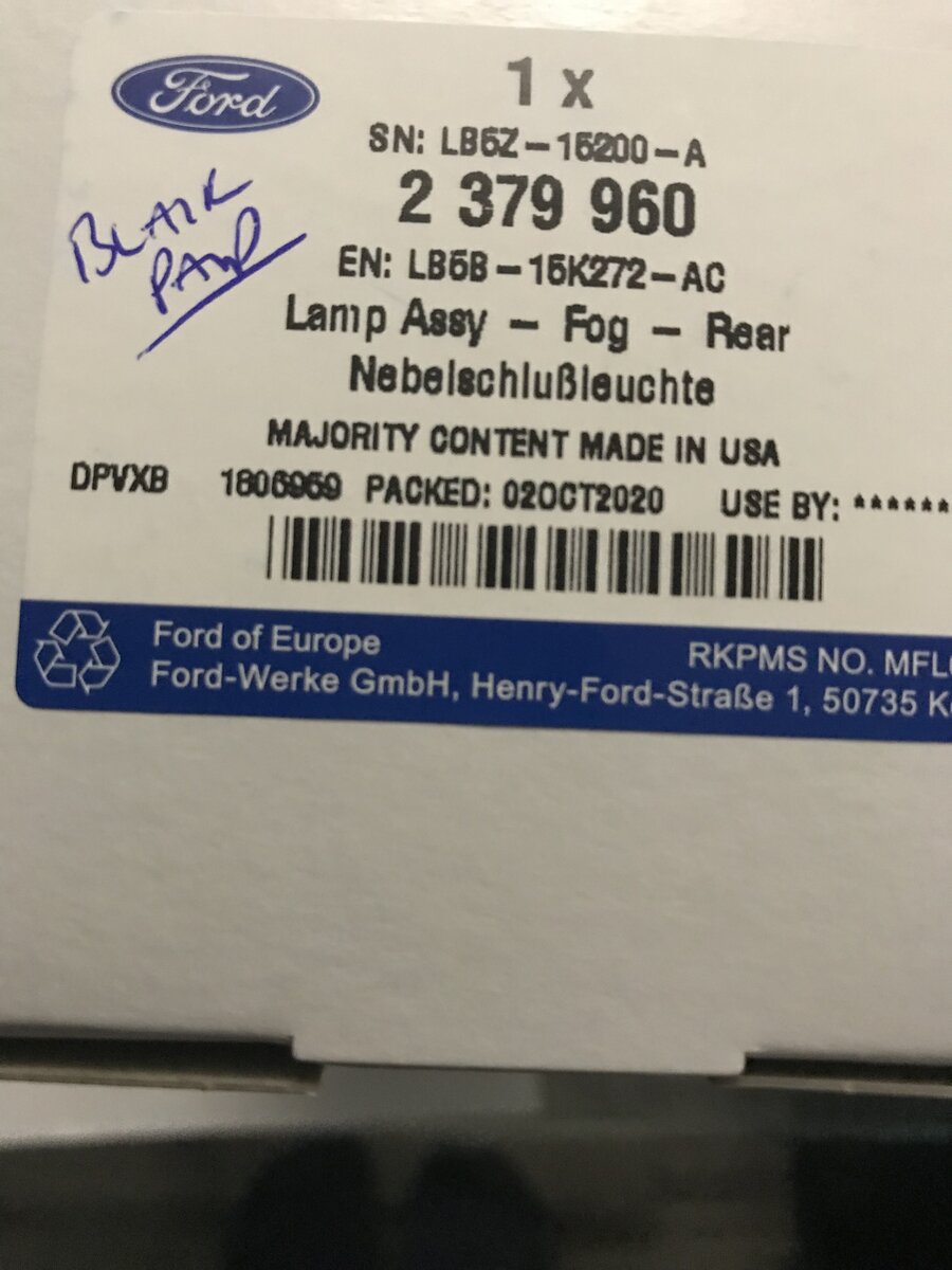

Hello thanks for your reply I will try and attach a picture of the part the plug socket looks blank? But the box clearly states Lamp Assy Fog Rear..
788FF615-198E-4BD9-AFEE-061A0D6A2C99.jpeg B2FF8DEE-9534-4D46-AAB5-2CE4C0B36A26.jpeg
Thanks Dale. That's what I thought it looked like. It definitely is not the rear fog lamp assembly.

Hello again I work for Ford in the UK so I will reach out to the team responsible for this part and see if they can shed some light for me, I will feed back any info I find out hopefully post a reply in the coming days.
Good luck with it.
Good luck with it.
Well mystery of the fog light solved… despite the Ford info showing as fog light the right hand light is a dummy! The left hand side has the lamp in.
Because I special ordered the unit and it is under £50 i cannot return it! Not even for a Ford Employee most miffed. So now I am in the process of researching how to fit led’s and wiring etc. Just thought I would let you know.
