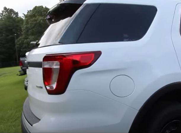

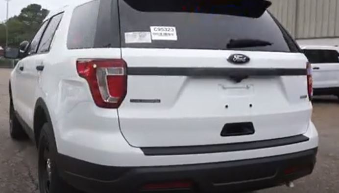

I spotted the same rear bumper protector in two different youtube videos and really like the look of it and how it folds over the edge just a bit. The civilian OEM protector doesn't fold over the edge and has the word EXPLORER on it. I prefer one like in the videos. However, I can't seem to find this particular protector/guard anywhere. Does anyone happen to recognize this protector and can tell me who makes it and where I could purchase one?
I rewatched one of the videos and the guy said they just came off of the truck, which tells me it's a factory part. But I haven't been able to find a part number on it yet.
EDIT: I believe I found it. It seems it came stock on the 2018-2019 MY. Mine's a 2017, that's why I had trouble finding the part number. However the rear bumper cover part number is the same for both years (2017 and 2018) so I imagine it will fit. 2018-2019 Ford Step Pad JB5Z-17B807-AA | Blue Springs Ford Parts

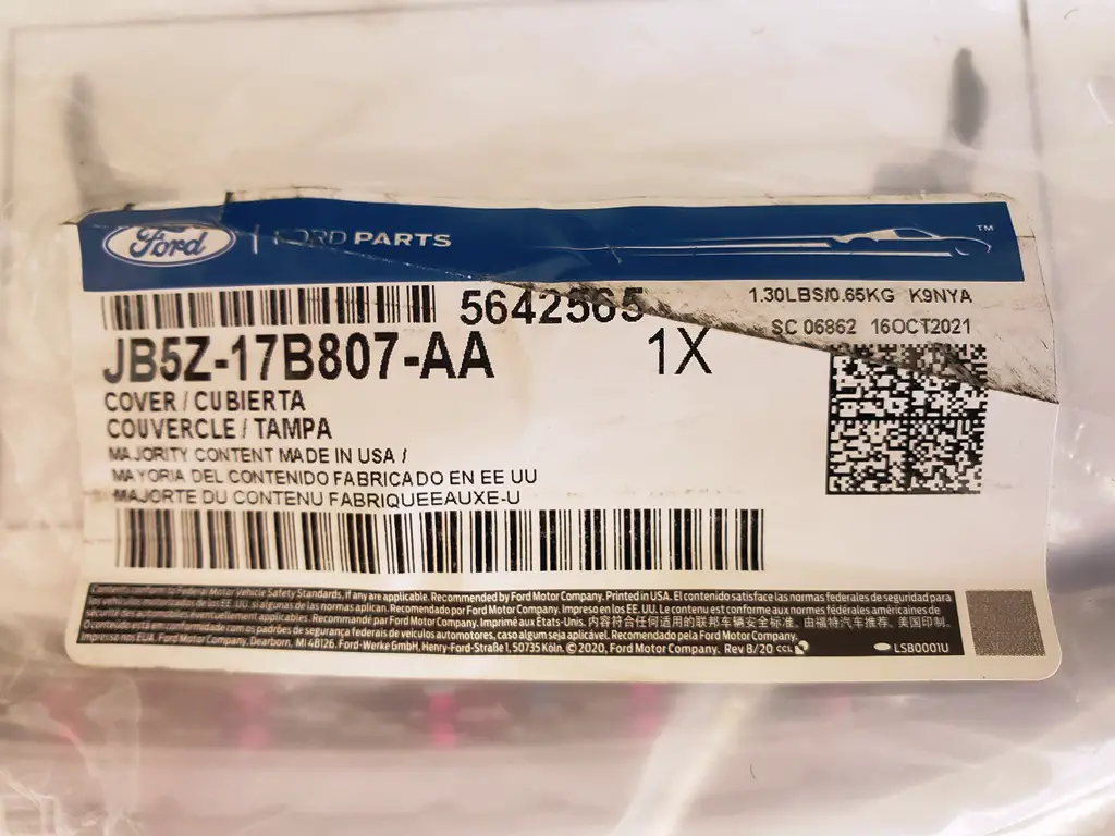

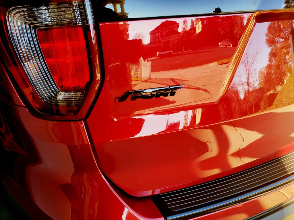

My 2018 Sport originally came with a two-piece "pad" on the top of the rear bumper cover (the two-piece version may be something that is exclusive to the Sport?). It had an outer edge piece that is painted Gloss Black, and then a matte insert, and both pieces snap into an intricate series of holes in the top of the bumper cover (see photos). Mine had gouges and scratches deep into the gloss black paint, but the cost of a brand-new painted "frame" piece was ridiculous. (I also didn't care for the piece being painted in the first place).
Because it looked bad, I decided to use this opportunity to instead convert it to the more basic, one-piece "wrap over the edge" insert that my previous Explorer (an XLT) had come with. so I ordered that piece from Ford instead of the two original part(s). When it came, it easily snapped-in to these same holes, while also cleaning-up the entire look for me.
I don't know what other model years this one-piece cover might fit, or if it might fit a PIU, but it easily fit my 2018 Sport perfectly; the part number is JB5Z-17B807-AA, and my local dealer's price was $54.72.
