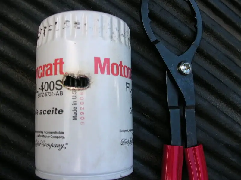

I purchased an 8.8 rearend from a salvage yard for my '99 Ranger to replace the 7.5. The rearend I picked up is 3L55 ratio and 28 spline axles. I will be picking up another rearend shortly out of an Explorer which is 3L73 with disc brakes and 31 spline axles. I plan on putting the 3.73's in place of the 3.55 in the Ranger rearend as my truck currently has 3.73 and I really like that ratio. I will either change out the side gears in the 28 spline Traction Lok or else use the entire unit out of the explorer depending on which one is in better shape. I believe the Explorer axles and disc brakes should swap in to the Ranger 8.8 housing. What I am curious about is how much trouble will it be to switch to disc brakes. I would imagine the master cylinder is different, emergency brake cables, but what about the ABS. Do i need to change anything as far as that is concerned. What about the proportioning valve? Thanks. P.S. Use caution when changing the oil filter on a '99 Ranger 3.0L The starter is close by with a HOT wire. Photo below.
