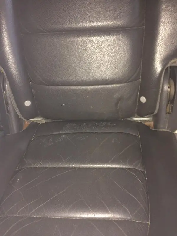

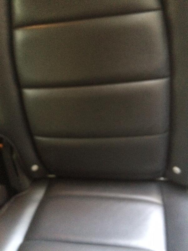

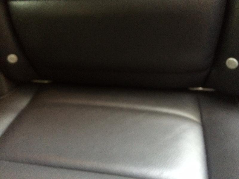

I have 2004 buckets and console in mine and they have seat anchors (first two pics). The third pic is the 1/3 side of a 2003 second row bench- it also has the seat anchors. That came from a bench out of a 7 seater vehicle- I can't say if a 5 seater would be exactly the same. So 3rd gen does have the anchors in the seats, but just not in your 02. The 02 Explorer had seats that in many cases were a bit of a hybrid between 2nd gen and 3rd gen. I had a 2nd gen previously and the second row look very similar to 02 second row. Changes were definitely made in 03 seats. You should be able to find usable 3rd gen seats from an 03-05.

BTW, look for the 2 grey "dots" on the seat, there is actually a little pic of a child seat on them. It's an easy way to identify that the seat has the anchors.
